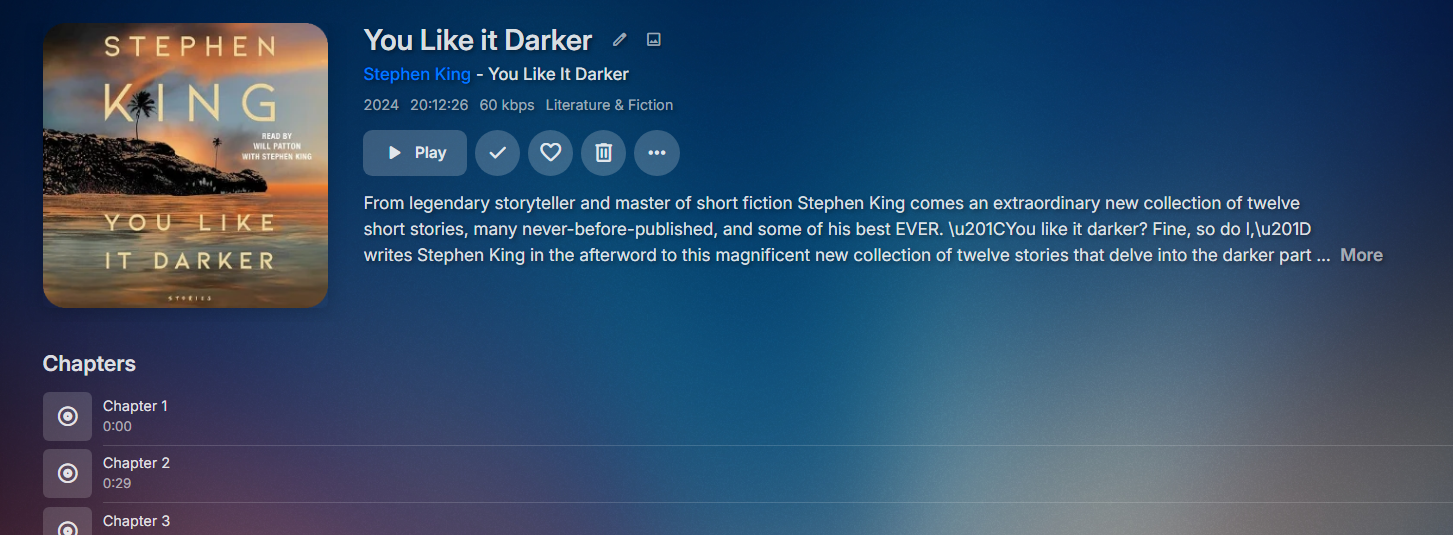

Happy2Play 9798 Posted May 28, 2024 Posted May 28, 2024 Not seeing an issue testing here Book shows image but internal tracks/chaptesr do not. Quote 2024-05-28 16:05:13.272 Debug ImageProcessor: Image encoding using Skia to C:\Users\Media\AppData\Roaming\Emby-Server\programdata\cache\temp\00f14265409b4cbba6d3f6da602fb2e6.webp took 21ms for E:\Media\AudioBooks\Stephen King\You Like It Darker\cover.webp. Now moving to C:\Users\Media\AppData\Roaming\Emby-Server\programdata\cache\images\resized-images\a\abbcaa24-59ad-6ef6-7867-4b89b913d424.webp But your log clearly shows your image being used Quote 2024-05-24 09:49:10.472 Info ProviderManager: Caching file from /mnt/emby/emby-b/fiction/Kitty Cat Kill Sat/cover.webp to /config/metadata/library/b3/b3b19aab17100d6dc987dfe776b961da/imagecache/cover.webp May need to see the results from ffprobe on the media. /bin/ffprobe -i file:"/mnt/emby/emby-b/fiction/Kitty Cat Kill Sat/Kitty Cat Kill Sat.m4b" -threads 0 -v info -print_format json -show_streams -show_chapters -show_format My test Spoiler C:\Users\Media>C:\Users\Media\AppData\Roaming\Emby-Server\system\ffprobe.exe -i file:"E:\Media\AudioBooks\Stephen King\You Like It Darker\Stephen King - You Like It Darker .m4b" -threads 0 -v info -print_format json -show_streams -show_chapters -show_format ffprobe version 5.1-emby_2023_06_25 Copyright (c) 2007-2022 the FFmpeg developers and softworkz for Emby LLC built with gcc 12.2.0 (Rev10, Built by MSYS2 project) { [mov,mp4,m4a,3gp,3g2,mj2 @ 0000022d50064e00] stream 0, timescale not set Input #0, mov,mp4,m4a,3gp,3g2,mj2, from 'file:E:\Media\AudioBooks\Stephen King\You Like It Darker\Stephen King - You Like It Darker .m4b': Metadata: major_brand : mp42 minor_version : 0 compatible_brands: mp42isom creation_time : 2024-05-21T09:00:16.000000Z gapless_playback: 1 description : From legendary storyteller and master of short fiction Stephen King comes an extraordinary new collection of twelve short stories, many never-before-published, and some of his best EVER. \u201CYou like it darker? Fine, so do I,\u201D writes Stephen King i genre : Literature & Fiction media_type : 2 date : 2024 WWWAUDIOFILE : https://www.audible.com/pd/You-Like-It-Darker-Audiobook/B0CMF7YJL9?ipRedirectOverride=true&overrideBaseCountry TMP_GENRE1 : Literature & Fiction title : You Like it Darker RELEASETIME : 2024 RATING WMP : 0.2 album : You Like It Darker comment : From legendary storyteller and master of short fiction Stephen King comes an extraordinary new collection of twelve short stories, many never-before-published, and some of his best EVER. \u201CYou like it darker? Fine, so do I,\u201D writes Stephen King i ASIN : B0CMF7YJL9 artist : Stephen King; Will Patton sort_album : You Like It Darker album_artist : Stephen King composer : Duration: 20:12:26.91, start: 0.000000, bitrate: 60 kb/s Stream #0:0[0x1](eng): Audio: aac (LC) (mp4a / 0x6134706D), 44100 Hz, stereo, fltp, 58 kb/s (default) Metadata: creation_time : 2024-05-21T09:00:16.000000Z vendor_id : [0][0][0][0] Stream #0:1[0x2](und): Data: bin_data (text / 0x74786574) Metadata: creation_time : 2024-05-21T09:00:17.000000Z Stream #0:2[0x0]: Video: mjpeg (Baseline), yuvj420p(pc, bt470bg/unknown/unknown), 500x500, 90k tbr, 90k tbn (attached pic)

Happy2Play 9798 Posted May 29, 2024 Posted May 29, 2024 But yes taking a jpg and converting it to webp and reembedding no long read the embedded image. So yes this is currently a limitation of ffprobe. @Luke
