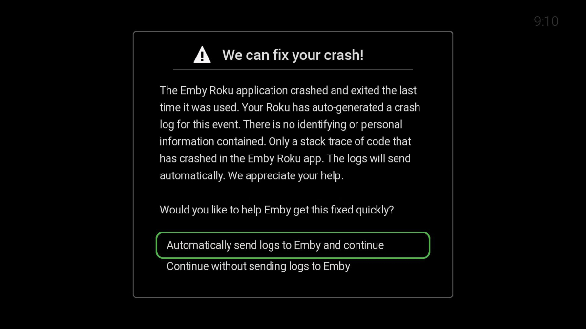

speechles 2062 Posted June 22, 2024 Posted June 22, 2024 (edited) @NinkoI have some good news regarding crashes. With Roku OS13 we have the ability to detect when the app launches if it crashed the last time it ran. You will be able to automatically send us the stack trace from when the app crashed on your Roku. We will have a dialog that spawns when the application starts that alerts you that we noticed your device has previously crashed. We will then ask you if you would like to send us logs. It does this all automatically without the user having to set the app into debug mode or do anything special at all. You literally just launch the app after a crash. It will allow us to then fix your issue if you choose to send us logs from the dialog. We cannot fix crashes we do not know about. So hopefully most of the users choose to send these crash logs to us. The next update to the Roku app should include this automatic crash logging ability. This will also allow every user experiencing crashes to send us anonymous stack traces to pinpoint exactly where these crashes occur in the app and how. It will make it much easier for users to participate in finding issues that cause the app to crash. We will know the exact place in the app these crashes occured and what the state of the objects were at that time. That will make it several orders of magnitude faster to have users report these issues and get them fixed quickly and easily. Better days are ahead. You won't have to make a forum post when the Roku app crashes after this. Please stay tuned. Edited June 22, 2024 by speechles 1 1

speechles 2062 Posted June 22, 2024 Posted June 22, 2024 (edited) You will see this as the app launches if you experienced a prior crash in the app. The text is subject to change. But we want to make it so users want to send us logs so we can fix their crash. After you choose an option the app will launch normally and continue loading. But it will wait until users make a choice here. It does not automate fully the sending of logs. We want users to choose to help us. Users are not required to help by sending logs. It is just nice to see since we cannot personally find all the crashes. Edited June 22, 2024 by speechles 2
