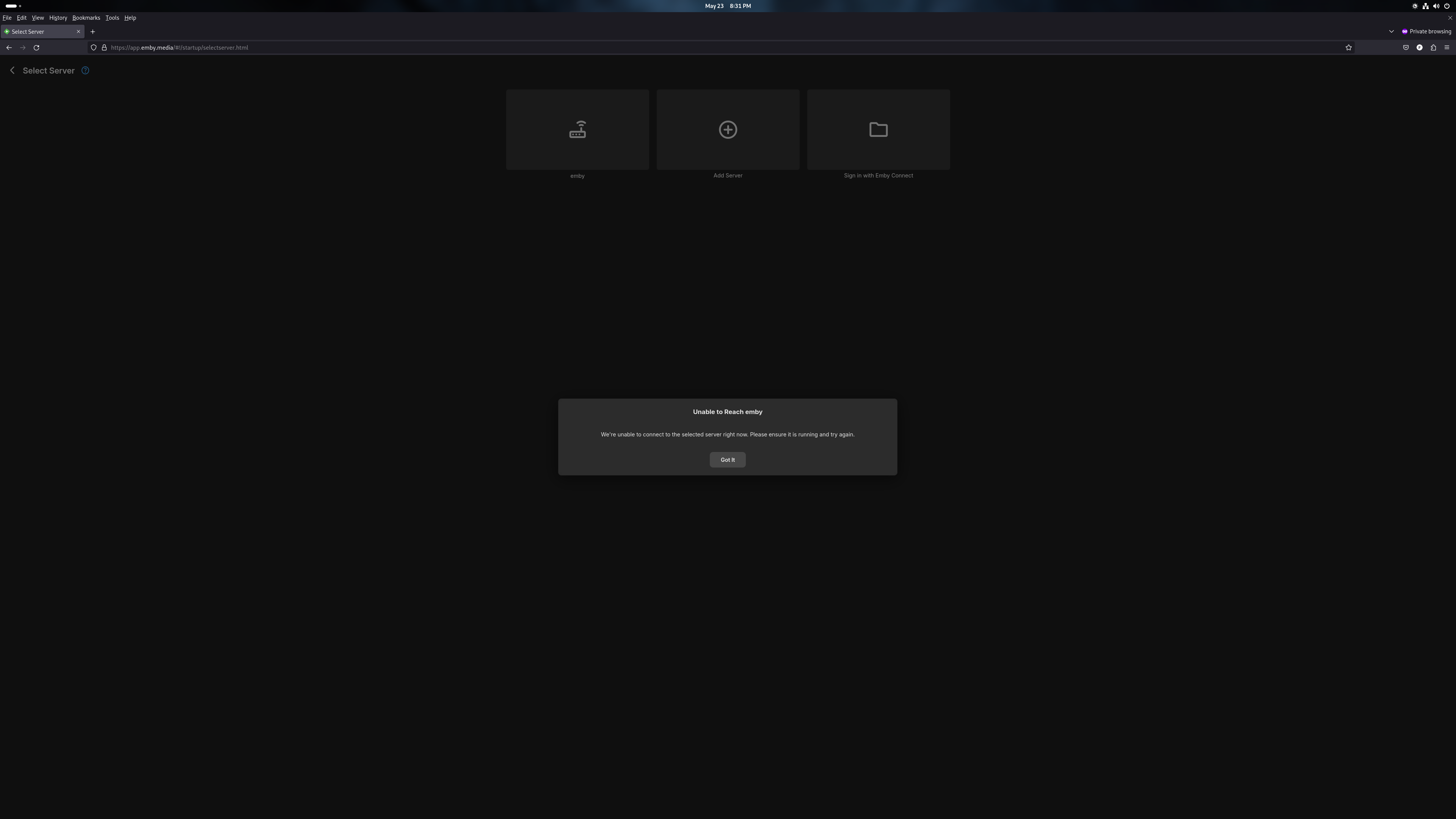

Cphusion 3 Posted May 22, 2024 Posted May 22, 2024 (edited) I'm trying to figure out how Emby Connect works so I can maybe try getting my Plex users to switch over to Emby. so I went to search for the documentation about it and ended up here. https://emby.media/support/articles/Emby-Connect.html From my understanding this would allow you to use the same credentials to authenticate to multiple Emby Servers if you are given access to them. So on my Emby server I added my Emby Connect email address under "(Optional) Emby Connect email address". After having verified this by clicking on an email that was sent to me there now is a cloud icon on the top right corner of my user where you see all the users listed. Then I do the following steps to sign into Emby Connect. 1. I go to: https://emby.media/connect.html 2. Click on Sign in and then I sign in with my Emby Connect e-mail address and password. 3. I end up on a select server screen, where I have to add a server. Add server, I thought they wouldn't need to add a server with Emby Connect? But I guess it still logical because my server isn't advertised anywhere. So I click on add server and add my host(https://emby.example.com) and port(443) and click connect, I'm using port 443 because I have reverse proxied Emby through my already existing web-server. 4. After which I end up in another login screen, which I am assuming is my Emby server. According to the documentation about Emby Connect, I would think that since my local user on my Emby server has an Emby Connect email address associated with it it would mean I should be able to login into my Emby server with either my Emby connect e-mail address and password or my Emby Connect username and password. But neither work, not even the local username of my Emby server and my Emby Connect password but what does work is my local Emby username and password. I then close my browser, open a new private browser session and repeat the process to login into Emby Connect again. To my surprise, the server I had previously added has vanished. I thought after adding it once the server would be saved for the future so that Emby Connect would make it easier to connect to different servers? I'm trying to figure this out so I can get my Plex users to switch over to Emby, but since I myself can't figure this out then my current Plex users that are none-technical aren't going to either. This shouldn't be so complicated I would think, what am I missing here? Can anyone explain to me why using Emby Connect doesn't do what is described in the documentation and help me understand to what I am missing so I can get it to work how it is described there? So in short I have two problems with Emby Connect: 1. Logging into my Emby Server with a local user that has an account connected to their Emby Account doesn't work with neither the Emby Connect e-mail address or Emby Connect username when using the Emby Connect password. 2. Emby Connect doesn't seem to save the servers that you added to Emby Connect because when you login into Emby Connect a second time in a clean browser session the previously added server is gone. I'd appreciate it if someone could help me figure this out or fill me in on what I am missing or doing wrong. Edited May 22, 2024 by Cphusion
Luke 42184 Posted May 22, 2024 Posted May 22, 2024 Quote 3. I end up on a select server screen, where I have to add a server. Add server, I thought they wouldn't need to add a server with Emby Connect? Hi, you are right, you should not have to. Maybe try removing the (Optional) Emby Connect email address, clicking save, and then adding it back.
Cphusion 3 Posted May 23, 2024 Author Posted May 23, 2024 (edited) 9 hours ago, Luke said: Hi, you are right, you should not have to. Maybe try removing the (Optional) Emby Connect email address, clicking save, and then adding it back. I did that now the server shows up, but when I try and connect it times out. When you add an an Emby Connect e-mail address to a local account what gets advertised back to your Emby Connect as in server details? I'm sort of getting the impression an ip adress with the default 8096 port? Is there a way to change that for when you are running Emby through a reverse proxy? Edited May 23, 2024 by Cphusion

Cphusion 3 Posted May 23, 2024 Author Posted May 23, 2024 1 minute ago, ebr said: Correct, but what does that have to do with you properly configuring the server so that Connect can use the proper address...? Because when I add my Emby Connect email adress to my local Emby User account, an Emby server shows up under Emby Connect. However I get a timeout when connecting of requesting server information. Since I am reverse proxying my Emby Server through local running webserver and in Emby dashboard it shows "Remote WAN adress: https://emby.mydomain.com:8920". I am getting the idea that Emby Connect is trying to connect to my Emby Server on that port. Which is what I am currently trying to debug, however I have directly opened that port now so that port is available from the outside world, however Emby Connect is still not able to connect after I add my Emby Connect e-mail address to my local account. So it seems to be something different. I see that you are an Administrator, could you please move this topic to the Linux section. I thought General would be okay but Linux might be better suited since the topic went on longer than I thought.
Cphusion 3 Posted May 23, 2024 Author Posted May 23, 2024 3 minutes ago, Cphusion said: Which is what I am currently trying to debug, however I have directly opened that port now so that port is available from the outside world, however Emby Connect is still not able to connect after I add my Emby Connect e-mail address to my local account. So it seems to be something different. So I am talking about this problem.
ebr 16307 Posted May 23, 2024 Posted May 23, 2024 4 minutes ago, Cphusion said: it shows "Remote WAN adress: https://emby.mydomain.com:8920". I am getting the idea that Emby Connect is trying to connect to my Emby Server on that port. Exactly. So you use the fields I pointed you to in network setup on the server to make that WAN address display show exactly the proper address for connecting remotely with your server. Once you do that, that is the address Connect will use.
Cphusion 3 Posted May 23, 2024 Author Posted May 23, 2024 2 minutes ago, Cphusion said: So I am talking about this problem. I got a bit further, it seems Emby Connect is trying to connect to my lan ip and port 8096, instead of the the "Remote (WAN) access" address. I think, since I saw my lan adress come across in Firefox debug mode on the console.
