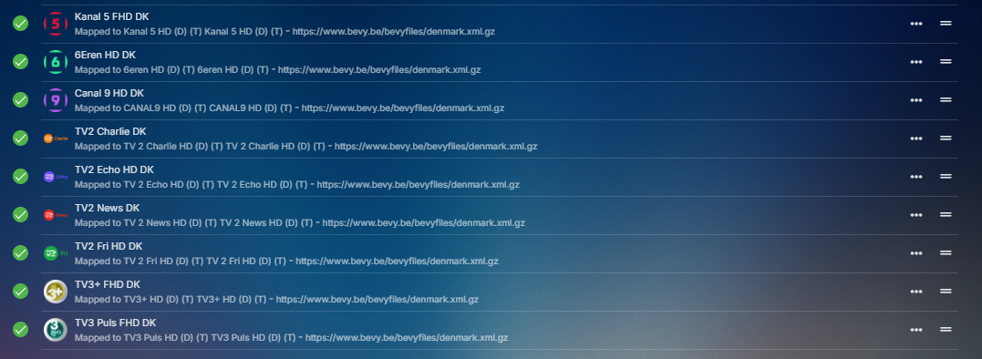

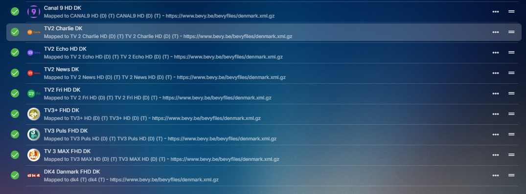

axelsl 19 Posted May 22, 2024 Posted May 22, 2024 Hello, This has happened for as long as I've used emby but I just cannot deal with it anymore, hence asking for help here. There is something very strange with my live tv channel ordering. When I move one channel from one position to another one, it causes part of the channel list to be totally messed up. Here is an example: Before: I move the channel DK4 Danmark FHD DK to one position above TV 3 MAX FHD DK You can see that both DK4 Danmark FHD DK and TV 3 MAX FHD DK have moved somewhere else! They are actually now higher in the list, not even next to each other! This is driving me crazy as it is making organizing my channels a nightmare. Can you please have a look? Logs attached Thank you Axel embyserver.txt 1
