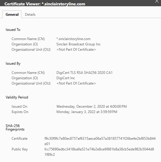

fwemby67 2 Posted June 23, 2024 Posted June 23, 2024 Here is the log after I rebooted the emby server and navigated to one of the channels. looks like the error is thrown when server tries to download channel logo https://static-25.sinclairstoryline.com/resources/assets/tennischannel/images/TennisChannel.whiteBg.png but the image can be opened from my chrome browser embyserver.txt
Happy2Play 9811 Posted June 23, 2024 Posted June 23, 2024 (edited) 3 hours ago, fwemby67 said: Here is the log after I rebooted the emby server and navigated to one of the channels. looks like the error is thrown when server tries to download channel logo https://static-25.sinclairstoryline.com/resources/assets/tennischannel/images/TennisChannel.whiteBg.png but the image can be opened from my chrome browser embyserver.txt 62.84 kB · 0 downloads The site itself has expired cert and have to acknowledge in browser to bypass. Since Emby does not acknowledge the issue it will not bypass the issue. So Emby error is actually correct. Edited June 24, 2024 by Happy2Play updated image
fwemby67 2 Posted June 23, 2024 Posted June 23, 2024 Yes, you are right. I remember I had to do that the first time when visiting the page from my browser. I guess Emby server doesn't have cert setup so it threw the error. However, I just found out why I didn't see the error before but now, because I reloaded my channels from M3U file but forgot to check "Allow mapping to guide data using channel numbers", which caused none of my channels are mapped to Emby guide hence logos are not loading from Emby guide but from the original M3U file instead. then these SSL errors start popping out. Thanks for helping out! 1
