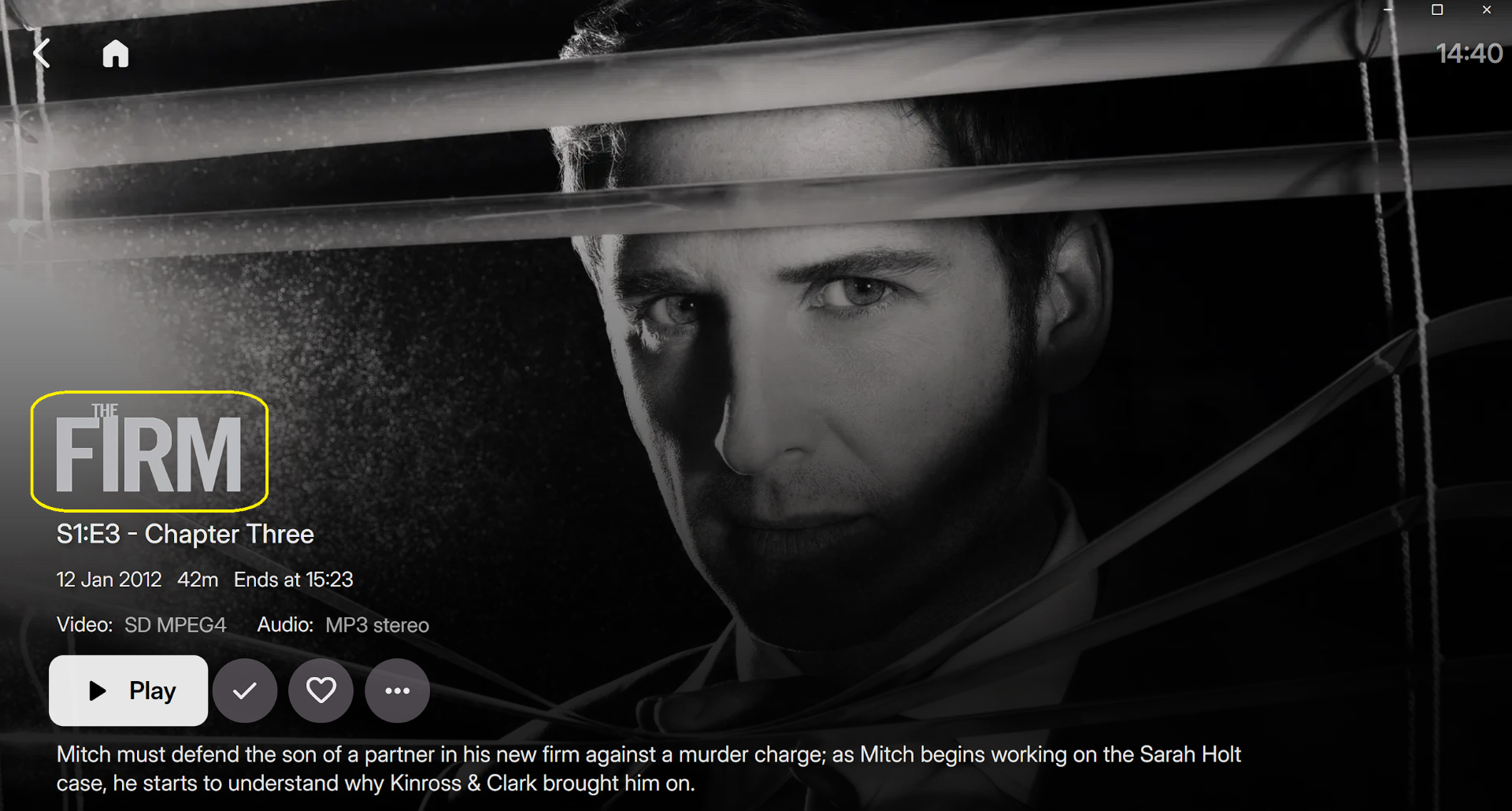

pgriffith 88 Posted May 20, 2024 Posted May 20, 2024 Theater 3.0.20 When using keyboard or an IR remote you cannot navigate to the Series once you're in an episode, the picture will explain all. The Series name highlighted by the yellow box can only be selected by a mouse, which is really inconvenient when you ONLY use an IR remote to navigate. Is this by design, an oversight, a bug, maybe I'm an idiot? It makes sense that hitting up once you're on any of the 4 buttons below it would select it.
Solution Luke 42235 Posted May 20, 2024 Solution Posted May 20, 2024 HI, it's in the 3-dot menu. Also in display settings if you disable the option to show logos as titles, then you'll be able to highlight the series name as you are expecting and click that.
