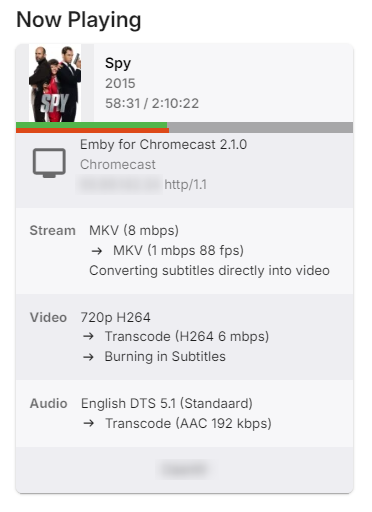

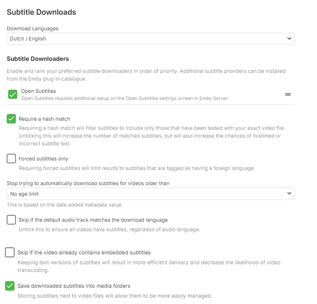

Imagnius 1 Posted May 20, 2024 Posted May 20, 2024 Hi all, apologies if this has already been asked, but I couldn't find it off hand... I noticed earlier this night that watching a film with subtitles caused my Synology NAS to cause the CPU to go up to (almost) 100%. From what I was able to find, it's down to "Converting subtitles into video". I also understood that that shouldn't happen if I have .srt files in the same location as the video file. How do I get Emby to download srt files into the right folders? That's not happening with the subtitle setup as I have it now.. Anyone any idea? Thanks in advance..

Luke 42184 Posted May 20, 2024 Posted May 20, 2024 Hi, what subtitle track was selected prior to starting playback? What subtitle format is it? Regarding downloading, have you taken a look at: Automatic Subtitle Downloads Manual Subtitle Downloads

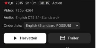

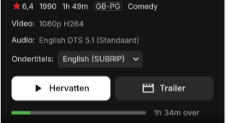

Imagnius 1 Posted May 20, 2024 Author Posted May 20, 2024 Hi Luke, Thanks for your reply. The first movie indicated there were subtitles (SUBRIP), but they wouldn't display on the Chromecast used. The second movie did display the subtitles (PGSSUB), but it caused the CPU to spike continuously at nearly 100%. Neither have .srt files in the movie folder. I have give RW permissions to both internal user emby, as the created user EmbyNas, to the Media folder and sub-folders and files, and configured subtitles as attached, but I don't see subtitle files being downloaded and placed with the media files. I'm sure I'm overlooking something, but I can't get my head around it just now.
visproduction 328 Posted May 20, 2024 Posted May 20, 2024 (edited) Using Chrome casting + DTS conversion + Subtitle conversion, at the same time. Would this perhaps cause heavy CPU and memory use, possibly exceeding Wifi casting and / or encoding for your hardware? It is nice that video / audio and subtitles can be converted on the fly. Normally, all commercial online media services offer content that is pre-converted, not really ever asking the user or the server to do the conversion on demand. Edited May 20, 2024 by visproduction
