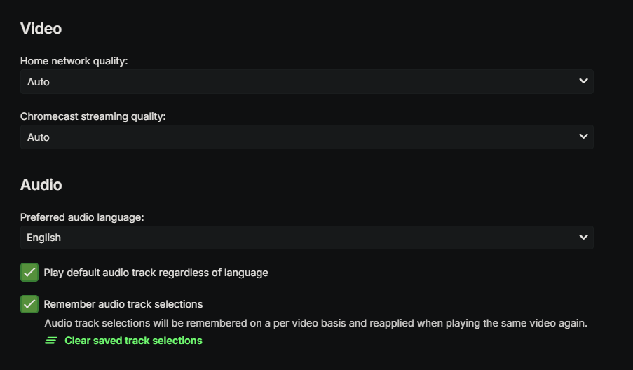

Riptide126 24 Posted May 30, 2024 Author Posted May 30, 2024 (edited) I attached a photo of my settings, it says that I do have home network quality set to auto, unless there is a different setting you guys are talking about Edited May 30, 2024 by Riptide126
Happy2Play 9814 Posted May 30, 2024 Posted May 30, 2024 Since this is a per client setting this if from the client you are having an issue with correct? But with this being a LAN connection I don't really understand why there 4Mb limit is applied. @Lukeis that the default fallback for this client on Auto? I guess one could test changing from Auto to a higher quality to see if playback changes.
