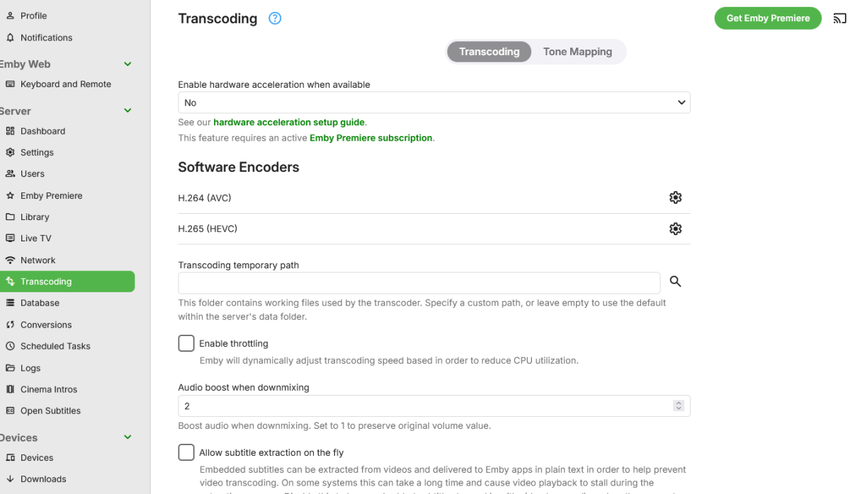

TallTrees 0 Posted May 20, 2024 Author Posted May 20, 2024 Also attaching a snip from the Settings screen:

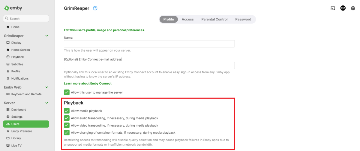

GrimReaper 4896 Posted May 20, 2024 Posted May 20, 2024 34 minutes ago, TallTrees said: Also attaching a snip from the Settings screen: You have diabled hardware accelerated transcoding, not transcoding altogether. Visible from your logs also: Quote >>>>>> User policy for emby Enable Playback Remuxing: True Enable Video Playback Transcoding: True Enable Audio Playback Transcoding: True If you want to disable transcoding (or remuxing), you need to do it on per-user basis in Settings>User>edit desired user: Note that disabling might lead to other issues and ultimately create more problems than actually solve, as denoted in option helper text.
TallTrees 0 Posted May 20, 2024 Author Posted May 20, 2024 Ok, understood. I will give that a shot. But then if there are other probs, what then? And I still don't get why this has become an issue now, when it wasn't before?

TallTrees 0 Posted May 20, 2024 Author Posted May 20, 2024 Luke, I turned off Video Transcoding under User Playback, and so far, it appears that has resolved the issue, with no other problems. Looking at Stats now, it shows the Stream as Deinterlacing Video, Video with 1080i and Direct Play, and Audio as Direct Play. There is no buffering during loading, and no buffering during Play. Back to full enjoyment! I have over 1000 videos, and use your Randomizer to watch them, sometimes for hours. I have stayed with Emby for years, and will continue to do so. I thought initially this problem was just a matter of proper settings, and it looks like this has been fixed. Not sure why this was never an issue before, but looking forward to enjoying Emby for years to come. Thank you for your quick assistance (and Grim Reaper also).
