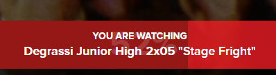

I don't think this is an Emby issue. But it is something I've seen recently when watching specials for TV shows in my library. The special has been identified properly by Emby, and is linked to the series it belongs to. But for some reason when watching the special in Emby (Emby for Kodi Next Gen and Emby Theatre), Trakt seems to think I'm watching something else. Example:
Babylon 5 - In the Beginning (Special E02 according to TVDB). Metadata is correct.
While watching the special, Trakt reports:
So far I've only seen Trakt reporting that I'm watching something different than what is actually being played in Emby when I'm watching specials for TV shows. I'm just posting to see if others have seen the same behavior.

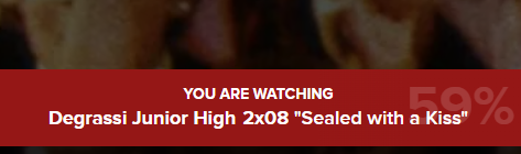

DarWun
And now I'm watching the third Babylon 5 Special, Thirdspace. Trakt thinks I'm watching"
Weird.

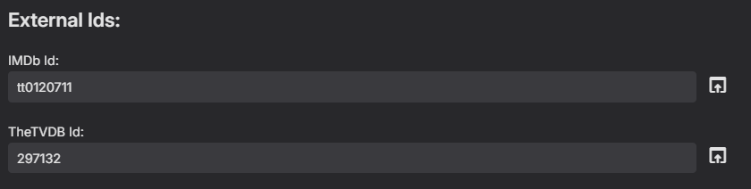

Hi, have you checked all of the external ids, both at the series and episode levels?
DarWun
I did. They are correct at both the series and episode levels. The external IDs for the special "Babylon 5 - S00E02 - In the Beginning" are:
Clicking on the links next to the IDs takes me to the respective pages at IMDb and TheTVDB. Emby has scraped all the correct metadata, and it reports the episode correctly when playing. But for some reason Trakt is reporting something else.
