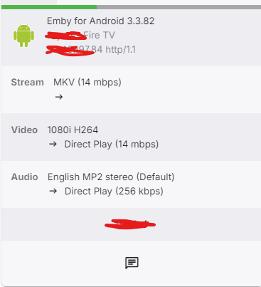

mbc0 68 Posted May 19, 2024 Posted May 19, 2024 (edited) Hi, Any idea how this situation can happen when streaming remotely? Version 4.9.0.20 beta Edited May 19, 2024 by mbc0
mbc0 68 Posted May 19, 2024 Author Posted May 19, 2024 100% it is my parents firestick 100 miles away
mbc0 68 Posted May 19, 2024 Author Posted May 19, 2024 This however is taking the mick! lol any idea why this is happening? I can see by the ip it is remote (and besides, I know they are 100 miles away)
Luke 42288 Posted May 20, 2024 Posted May 20, 2024 Yea the server must think it’s a local connection. If that’s true then misconfigured network settings are the most likely cause.

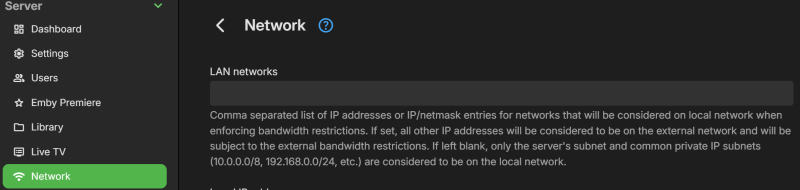

mbc0 68 Posted May 20, 2024 Author Posted May 20, 2024 Hi, These are my configured networks and the ip in question began with 90 Very strange!

Luke 42288 Posted May 26, 2024 Posted May 26, 2024 OK, I would try blanking out the lan networks option and then see how things compare.

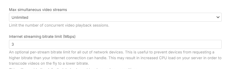

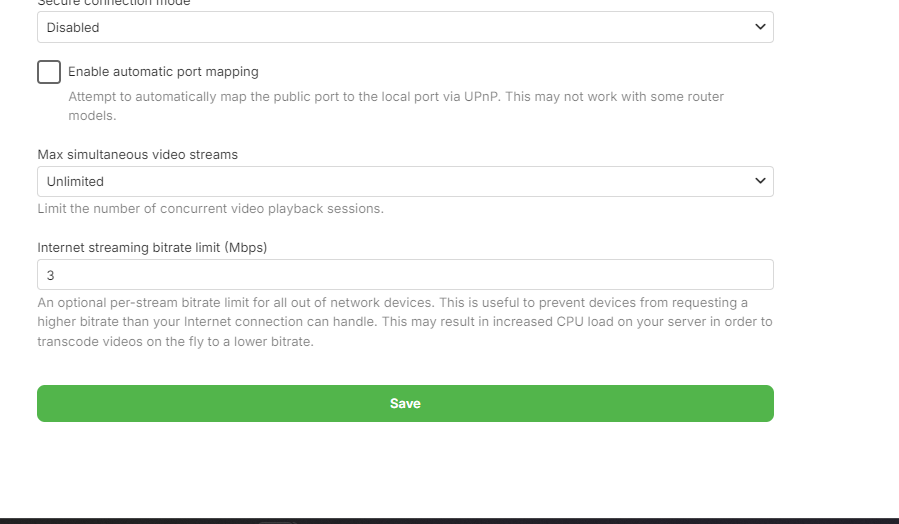

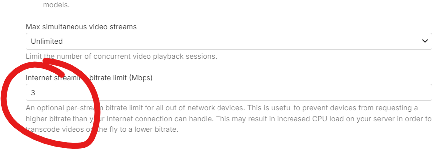

mbc0 68 Posted June 9, 2024 Author Posted June 9, 2024 Hi, Not had a chance to look at this but still having issues unfortunately, This is the current situation as my parents are watching now despite manually setting the user to 3mb/s I have manually set their user to 3mb/s (pic below) Emby Global settings are also set to 3 (pic below) all other users obey this global setting so any idea how I can fix this?
mbc0 68 Posted June 9, 2024 Author Posted June 9, 2024 Just found this in the log 2024-06-09 10:12:30.076 Info App: User policy for bryde4. EnablePlaybackRemuxing: True EnableVideoPlaybackTranscoding: True EnableAudioPlaybackTranscoding: True 2024-06-09 10:12:30.076 Info App: RemoteClientBitrateLimit: 3000000, RemoteIp: host5, IsInLocalNetwork: False 2024-06-09 10:12:30.076 Info App: Bitrate exceeds DirectPlay limit: media bitrate: 6381883, max bitrate: 3000000 2024-06-09 10:12:30.076 Info App: Bitrate exceeds DirectStream limit: media bitrate: 6381883, max bitrate: 3000000 2024-06-09 10:12:30.077 Info App: RemoteClientBitrateLimit: 3000000, RemoteIp: host5, IsInLocalNetwork: False 2024-06-09 10:12:30.077 Info App: Bitrate exceeds DirectPlay limit: media bitrate: 6381883, max bitrate: 3000000 2024-06-09 10:12:30.077 Info App: Bitrate exceeds DirectStream limit: media bitrate: 6381883, max bitrate: 3000000 2024-06-09 10:12:30.077 Info App: RemoteClientBitrateLimit: 3000000, RemoteIp: host5, IsInLocalNetwork: False 2024-06-09 10:12:30.077 Info Server: http/1.1 Response 200 to host5. Time: 20ms. POST http://host4:8096/emby/Items/1074050/PlaybackInfo?UserId=25f305c44113447388479c94337ce180&StartTimeTicks=0&IsPlayback=false&AutoOpenLiveStream=false&MaxStreamingBitrate=734003200&X-Emby-Client=Emby for Android&X-Emby-Device-Name=Bryan's Fire TV&X-Emby-Device-Id=8f004588af3db658&X-Emby-Client-Version=3.3.82&X-Emby-Token=x_secret1_x&X-Emby-Language=en-gb&reqformat=json
