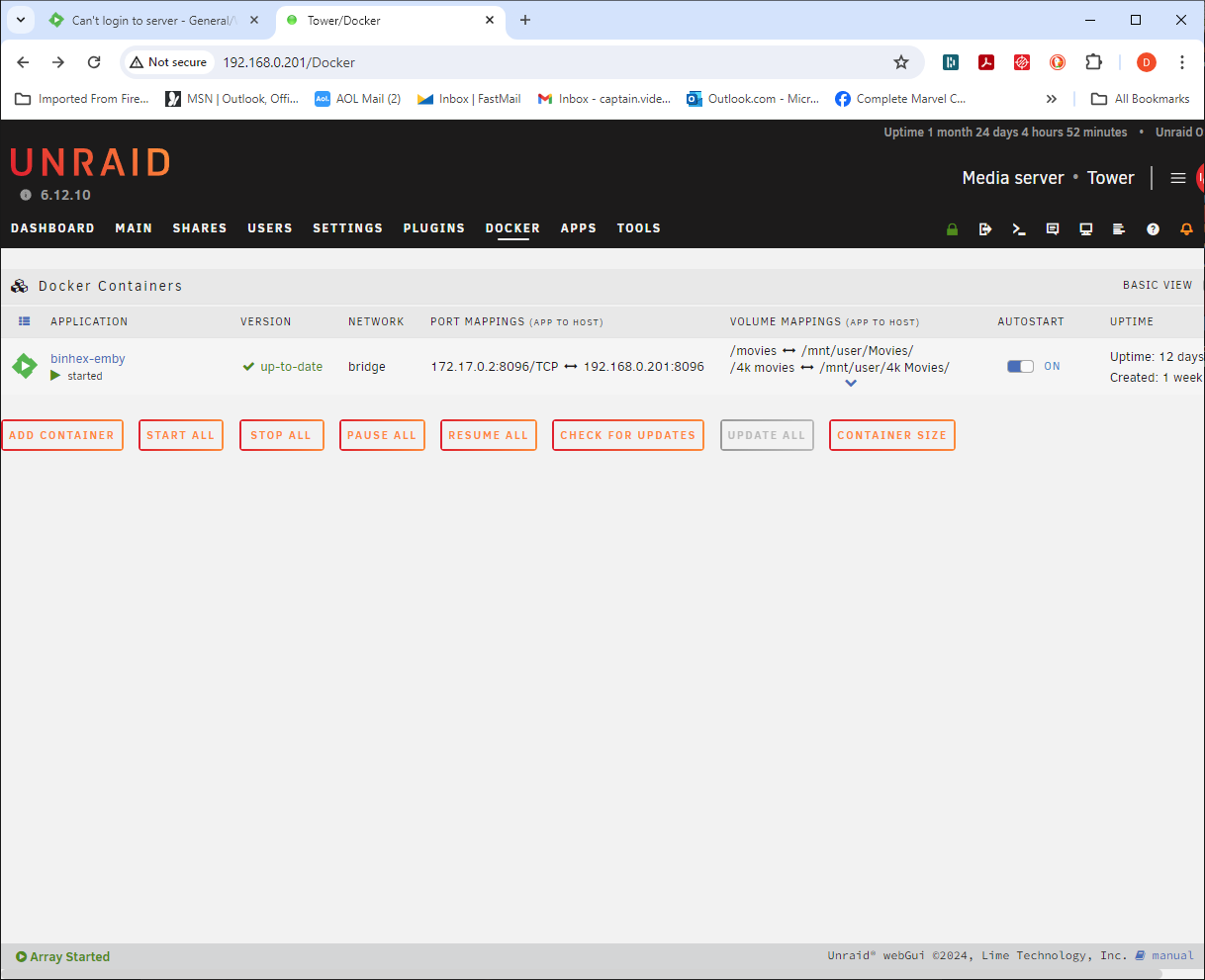

johnnorris
I honestly don't recall how I set it up since it's been well over a year since I did it.  Here's a screenshot that shows the port mapping for the docker:
Lessaj
Yea it's using a bridge, you can see it right in the screenshot that it's mapping 172.17.0.2 to 192.168.0.201, but the docker will only be aware of the 172 address. I'm not sure how to adjust this in unraid.

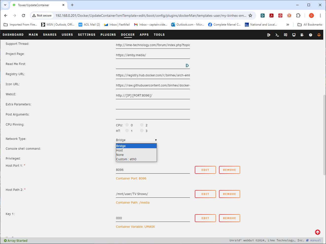

johnnorris
Here's the Network Type options for the Emby docker in unRAID.  As you can see there are several different options to choose from.  I never made any adjustments to this setting and apparently the Bridge option is the default setting.  I'm hesitant to change it since everything is working fine and I have four Android boxes with Emby connected to the server over my home network so probably best not to screw with it.
Lessaj
Host is probably the correct option but if it's working you're certainly free to leave it alone. :)
