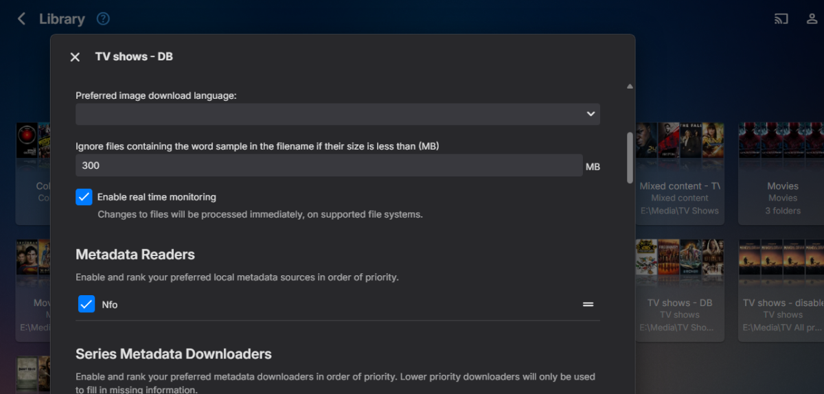

Crarbo1 1 Posted May 20, 2024 Author Posted May 20, 2024 Happy2Play, Thanks for the quick response. I didn't think to look there. I figured there would be a general setup for the library that would cover all libraries that would be added in the future. I guess it does make sense to have it on a individual basis though. I don't remember having to set this up during install, but maybe I overlooked it. Either way, her is my info: For my Movies library: Metadata Readers: Nfo-unchecked Movie Metadata Downloaders: TheMovieDb-unchecked The Open Movie Database-checked The TVDB-unchecked Metadata Savers: Nfo-unchecked Movie Image Fetchers: TheMovieDb-unchecked TheTVDB-unchecked FanArt-unchecked The Open Movie Database-checked Image Capture-unchecked For my TV Shows library: Metadata Readers: Nfo-checked Series Metadata Downloaders: The TVDB-unchecked TheMovieDb-unchecked The Open Movie Database-checked Season Metadata Downloaders: TheMovieDb-checked Episode Metadata Downloaders: The TVDB-unchecked TheMovieDb-checked The Open Movie Database-checked Metadata Savers: Nfo-unchecked Series Image Fetchers: TheTVDB-unchecked FanArt-unchecked TheMovieDb-checked The Open Movie Database-checked Season Image Fetchers: TheTVDB-unchecked FanArt-checked TheMovieDb-checked Episode Image Fetchers: TheTVDB-unchecked TheMovieDb-checked The Open Movie Database-checked Image Capture-unchecked So, I'm not sure why they are set this way but I am sure this is my issue. My only problem is I don't know what to use or in what order to use for each setting. Any idea's? Thanks, Chuck
Happy2Play 9798 Posted May 20, 2024 Posted May 20, 2024 35 minutes ago, Crarbo1 said: Movie Metadata Downloaders: TheMovieDb-unchecked The Open Movie Database-checked The TVDB-unchecked Series Metadata Downloaders: The TVDB-unchecked TheMovieDb-unchecked The Open Movie Database-checked Per just this alone you are limiting yourself so you will not get any info from TMDB or TVDB. As for images you will not have ids to get images so again limited per actual known metadata. Since this is not a default configuration I can only guess you disable default options. In general you want at minimum TMDB then alternate TVDB/OMDB for Movies. Ideally for Shows/Series you want TVDB then TMDB and I don't bother with OMDB but that is personal preference. Images per library usually for movies I have FanArt then TMDB/TVDB and Shows/Series FanArt then TVDB/TMDB. But everyone has their own preferences. So you need to reevaluate your library settings. This is all guess work with the info provided without logs showing exactly what was queried and from where.
Crarbo1 1 Posted May 20, 2024 Author Posted May 20, 2024 1 minute ago, Happy2Play said: Per just this alone you are limiting yourself so you will not get any info from TMDB or TVDB. As for images you will not have ids to get images so again limited per actual known metadata. Since this is not a default configuration I can only guess you disable default options. In general you want at minimum TMDB then alternate TVDB/OMDB for Movies. Ideally for Shows/Series you want TVDB then TMDB and I don't bother with OMDB but that is personal preference. Images per library usually for movies I have FanArt then TMDB/TVDB and Shows/Series FanArt then TVDB/TMDB. But everyone has their own preferences. So you need to reevaluate your library settings. This is all guess work with the info provided without logs showing exactly what was queried and from where. Thanks for the suggestions. I don't remember disabling those but either way, I will adjust my settings per your suggestions. I'm confident that this will resolve my issue. Thanks again for all the help!
Happy2Play 9798 Posted May 20, 2024 Posted May 20, 2024 Just now, Crarbo1 said: Thanks for the suggestions. I don't remember disabling those but either way, I will adjust my settings per your suggestions. I'm confident that this will resolve my issue. Thanks again for all the help! Then I would do a Refresh-Search for missing again entire libraries. But you can test on a single movie/series.
Crarbo1 1 Posted May 20, 2024 Author Posted May 20, 2024 8 minutes ago, Happy2Play said: Then I would do a Refresh-Search for missing again entire libraries. But you can test on a single movie/series. I checked like you suggested and it worked as I would expected, so I am now refreshing everything now. Thanks again! 1
