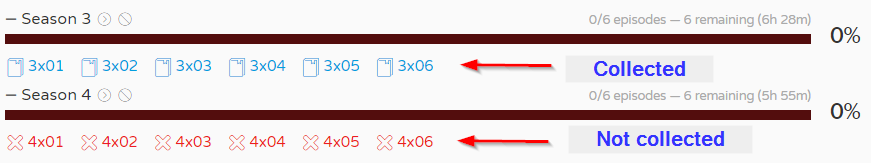

Victor240 1 Posted June 20, 2024 Author Posted June 20, 2024 From the screenshot, I posted in my previous post. That's how the episodes are shown in Trakt when they are missing and below, you can see how they are when they have been collected.
Luke 42150 Posted June 21, 2024 Posted June 21, 2024 What should that look like? Can you try a different series?
Victor240 1 Posted June 23, 2024 Author Posted June 23, 2024 Hi @Luke, You can see in the picture below that when episodes are added to emby's library and are synced with trakt, they are shown as "collected" (Season 3). When episodes are missing, like in season 4, they are shown as not collected with the red "X". I've tried different series and it's the same, emby's library is not synching with trakt.

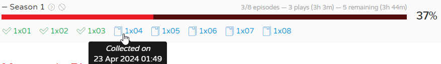

Victor240 1 Posted June 23, 2024 Author Posted June 23, 2024 I've tried with two different series and it seems to be working. I see this error in the logs, but if it works, it works. 2024-06-23 11:40:01.187 Error Trakt: Error syncing trakt data for user embysvr *** Error Report *** Version: 4.8.8.0 Command line: /volume1/@appstore/EmbyServer/system/EmbyServer.dll -programdata /var/packages/EmbyServer/var -ffdetect /var/packages/EmbyServer/target/bin/ffdetect -ffmpeg /var/packages/EmbyServer/target/bin/ffmpeg -ffprobe /var/packages/EmbyServer/target/bin/ffprobe -nolocalportconfig -ignore_vaapi_enabled_flag -pidfile /var/packages/EmbyServer/var/EmbyServer.pid -defaultdirectory /volume1/Public -updatepackage emby-server-synology72_{version}_armv8.spk Operating system: Linux version 4.4.302+ (root@build8) (gcc version 12.2.0 (GCC) ) #64570 SMP Thu Jul 20 00:06:53 CST 2023 Framework: .NET 6.0.25 OS/Process: arm64/arm64 Runtime: volume1/@appstore/EmbyServer/system/System.Private.CoreLib.dll Processor count: 4 Data path: /var/packages/EmbyServer/var Application path: /volume1/@appstore/EmbyServer/system System.NullReferenceException: System.NullReferenceException: Object reference not set to an instance of an object. at Trakt.ScheduledTasks.SyncFromTrakt.SyncTraktDataForUser(User user, TraktUser traktUser, Double currentProgress, CancellationToken cancellationToken, IProgress`1 progress, Double percentPerUser) at Trakt.ScheduledTasks.SyncFromTrakt.Execute(CancellationToken cancellationToken, IProgress`1 progress) Source: Trakt TargetSite: Void MoveNext()
