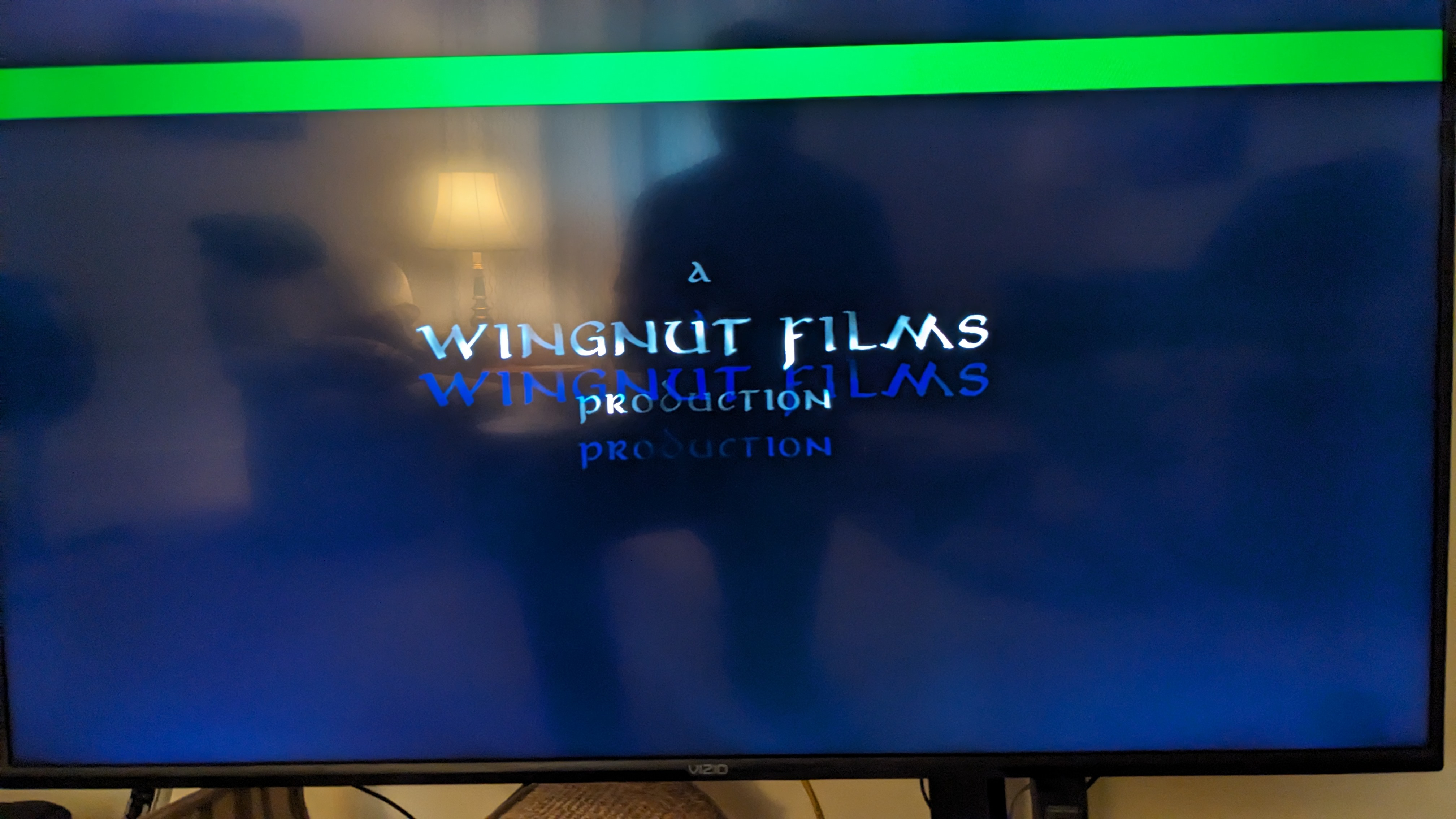

jshankles 0 Posted May 18, 2024 Posted May 18, 2024 I've watched this video before, and it was fine. This started last night. You can see from the image that there is a green bar across the top of the image, and the image itself is ghosted. This only happens on my roku client, and only with this video. It looks fine on my adroid emby app and windows app. I hope you can help... I've attached every log file I can think of as well as the output from mediainfo. media-info.txt hardware_detection-63851627863.txt ffmpeg-transcode-f4273699-7e0d-4645-92fe-8ef6dc235dbc_1.txt embyserver (1).txt

speechles 2062 Posted May 18, 2024 Posted May 18, 2024 (edited) 11:18:15.862 [AVHWDeviceContext @ 0000013cb37464c0] Using D3D11 device 8086:4680 (Intel(R) UHD Graphics 770). 11:18:16.223 Stream #0:0 (av1) -> hwmap:default (graph 0) 11:18:16.223 vpp_qsv:default (graph 0) -> Stream #0:0 (h264_qsv) >>>>>> Hardware Decoders for av1 [X] QuickSync Intel UHD Graphics 770 - AV1 [X] DX11VA Intel UHD Graphics 770 - AV1 >>>>>> Hardware Encoders for h264 [X] QuickSync Intel UHD Graphics 770 - H.264 (AVC) >>>>>> Selected Codecs Decoder DX11VA Intel UHD Graphics 770 - AV1 Adapter #0: 'Intel(R) UHD Graphics 770' Id:18048 (Driver: , Vendor: 32902) Max Bitrate: 293 Mbit/s - Frame Sizes: max 8192x4352 Color Formats: NV12, P010, YUV420P - Bit Depths: 8, 10 Profiles: Main (Level 5.0) Encoder QuickSync Intel UHD Graphics 770 - H.264 (AVC) Adapter #0: 'Intel(R) UHD Graphics 770' Id:18048 (Driver: , Vendor: 32902, SDK Version: 1.255) Max Bitrate: 234 Mbit/s - Frame Sizes: 32x32...4096x4096 - Width Alignment: 16 - Height Alignment: 16 Color Formats: NV12 - Bit Depths: 8 Profiles: Baseline Profile (Level 5.2), Main Profile (Level 5.2), High Profile (Level 5.2) Can you uncheck DX11VA in your advanced hardware transcoding settings for decoding and see if it works with both decode/encode using quicksync? The issue might be caused by different methods decoding and encoding the material. Edited May 18, 2024 by speechles
jshankles 0 Posted May 18, 2024 Author Posted May 18, 2024 Just tried running the video after unchecking DX11VA and restarting the server. Unfortunately the problem persists. I do appreciate the help as I am clueless.

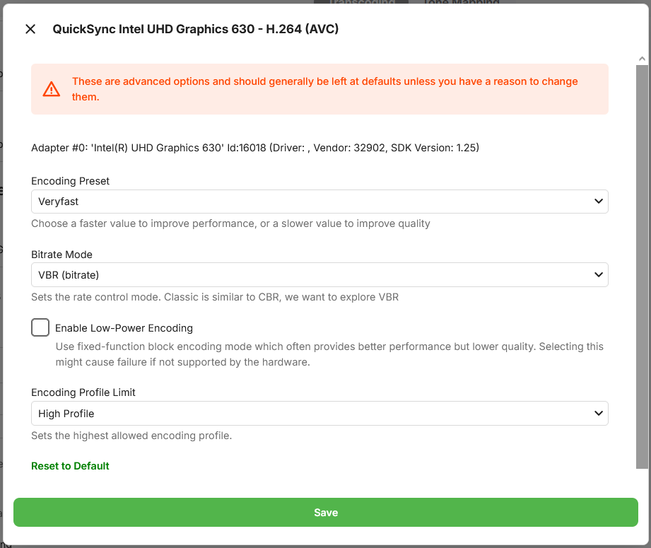

speechles 2062 Posted May 18, 2024 Posted May 18, 2024 (edited) I have kind of the same problem playing AVI container (not AV1 like you) with XVID on my Roku. The hardware encoder with QuickSync produces green all over the screen. I have to uncheck the quicksync hardware encoder and only software encode those or it will not play correctly. You can try to change some settings inside the COG. Once you click it the menu below opens up. If you completely mess it up and nothing plays you can always "Reset to Default" at the bottom and save. The bitrate mode and encoding profile limit are what I change at times. Edited May 18, 2024 by speechles

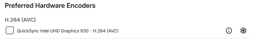

jshankles 0 Posted May 18, 2024 Author Posted May 18, 2024 (edited) Unchecking the h.264 hardware encoder seems to fix it. But now that means essentially I've disabled hardware encoding for all videos? Thank you for the help! Edited May 18, 2024 by jshankles
speechles 2062 Posted May 18, 2024 Posted May 18, 2024 (edited) 27 minutes ago, jshankles said: Unchecking the h.264 hardware encoder seems to fix it. But now that means essentially I've disabled hardware encoding for all videos? Thank you for the help! Yes. It means that ALL your videos will softwork encode, but still using hardware to decode frames. The heavy lifting of AV1 is the decoding. @softworkzNot sure you've seen this. You may know a better cure for this condition than I do. Edited May 18, 2024 by speechles
