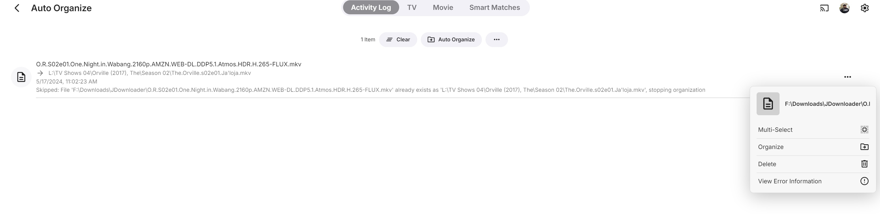

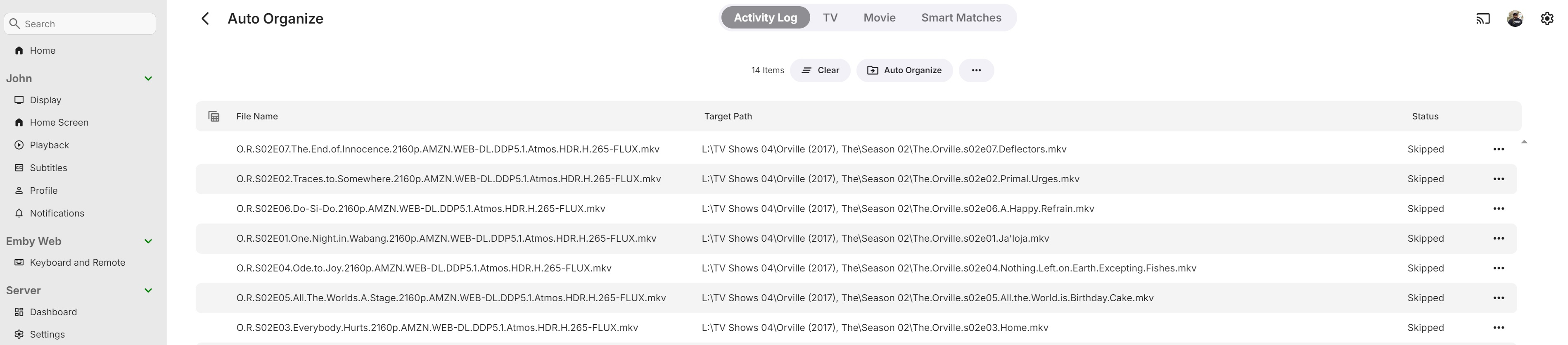

diaz1510 154 Posted May 17, 2024 Posted May 17, 2024 (edited) I've got season 2 of Outer Range I'm trying to auto organize. The show was downloaded as "O.R.s02e01........" I've got season 1 in my library already. Emby is trying to match the show to "The Orville" which I also have in my library. It isn't auto-organizing because I already have a season 2 in The Orville, which is fine, but there is no way to manually select Outer Range as the show I want to Smart Match to. Or maybe I'm missing something. I don't really like the new Auto organize interface, tbh...it doesn't feel as intuitive or as easy to use... What am I missing? Am I simply doing it wrong? How can I manually change which show I want to match it to like it used to be able to? There used to be a folder icon to click on which would open a dialog box to manually select which show in my library to smart match it to...what happened to that dialog box? The target path should be "L:\TV Shows 04\Outer Range (2022)\Season 02\........." There is no way to change the target path... Edited May 17, 2024 by diaz1510
Luke 42150 Posted May 17, 2024 Posted May 17, 2024 Given that the naming of O.R. is not obvious, I would say your best bet is to use the 3-dot menu to select the option to organize manually.
diaz1510 154 Posted May 17, 2024 Author Posted May 17, 2024 (edited) 1 hour ago, Luke said: Given that the naming of O.R. is not obvious, I would say your best bet is to use the 3-dot menu to select the option to organize manually. sigh....yes...I already tried that. Unless I am completely missing a DIFFERENT set of 3 dots. When I select "organize" from the 3 dots, it just gives me the option to file it under "The Orville" and I don't get any option to select anything different. So what am I missing here? I'm never given the opportunity to select a different series. And I know the error is because episode 1 of season 2 for The Orville already exists and I have Emby setup to skip episodes that already exist. Edited May 17, 2024 by diaz1510
Luke 42150 Posted May 17, 2024 Posted May 17, 2024 OK I see what's going on. When no series is detected at all, then you get a more robust dialog that lets you search for a series. When the series is already detected, this is what you get. I wonder if we can just display the bigger dialog in all cases.
