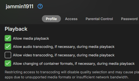

EmYaj 25 Posted May 16, 2024 Posted May 16, 2024 This may be by design but feels a bit weird, when I have one user with multiple streams the dashboard flips through all of their streams at seemingly random pace. Sometimes it stops or sits on one stream for a while before flipping to the next one and sometimes it flips through very quickly like in the video attached. (user jammin1911 in this example). Is this normal? I would have thought I would see three separate entries on the dashboard for this user rather than 1 entry flipping between 3 different streams. Also something else I noticed that was unexpected was that one of the stream is "reducing bitrate due to quality setting" but as far as I know this user does not have permission to do this. (it's me, and I didnt set any change to quality manually). I attached a screenshot of this user's playback permissions from the account - I don't think it should be allowed to reduce bitrate due to a quality setting of any sort. multiplestreams.mp4 1
