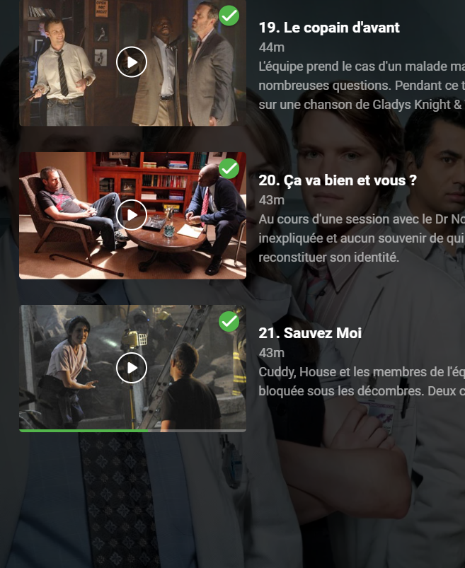

Fl0ppy 3 Posted May 16, 2024 Posted May 16, 2024 Hello everyone, I am writting this post because I have a small problem with my current tv show (Dr. house). In France, we have 22 episodes for the season 6 (the first one was split in half). The cool thing is that on TMDB (id: 1408) we have all the 22 episodes displayed. Even though I manually "identify" my tv show by the TMDB id, it stays at 21 episodes. I think the problem may come from the identification process, because on IMDB (id: tt0412142) and on TVDB (id: 73255), both show 21 episodes. I can still watch this serie on my laptop to get all the 22 episodes, but it would be better directly on my tv with emby on. I have attached pictures to show my folder, the steps I do and the result on Emby Hope to hear from you soon. Regards,

Fl0ppy 3 Posted May 16, 2024 Author Posted May 16, 2024 Well, I think that it was initially a big episode like 1+hour long and they decided to break it apart. So I have two episodes of 45 minutes each. (22 episodes of 45 minutes in total). And when I watch an episode on Emby (the forth for example), it shows me the fifth. The french names for the episodes 1 and 2 are "Toucher le fond ..." and "... et refaire surface" But on IMDB and TVDB, it is only one episode named "Toucher le fond...et refaire surface" However, it still has a good naming on tmdb (see picture)
