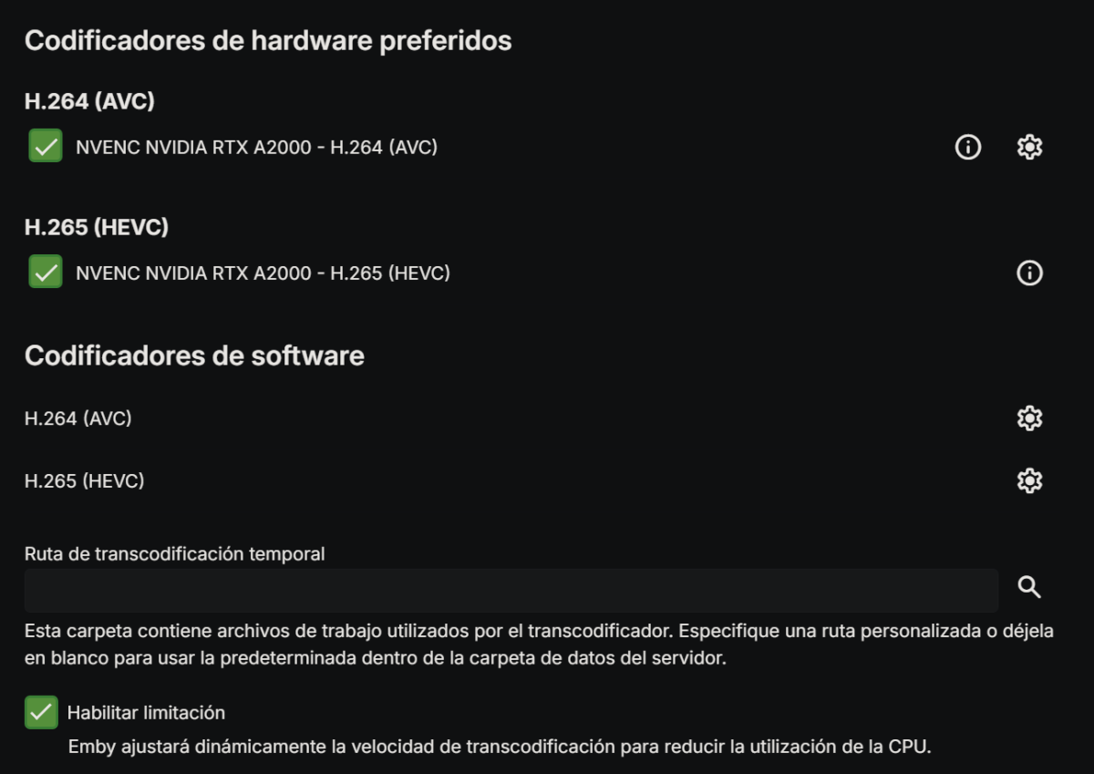

Lessaj 484 Posted May 14, 2024 Posted May 14, 2024 4 minutes ago, Gabi92 said: I haven´t changed anything regarding the throttling, everything is on default settings, how can i change it? From the Transcoding Tab. If you're using an A2000 this is a good page to look at to make sure it's actually able to use it. I don't think you'll wear the SSD before you actually replace it. I've been using the same scratch drive SSDs for years, read and written many many TB both for media preparations as well as transcoding temp files and 0 errors. A drive can still fail at any time of course.

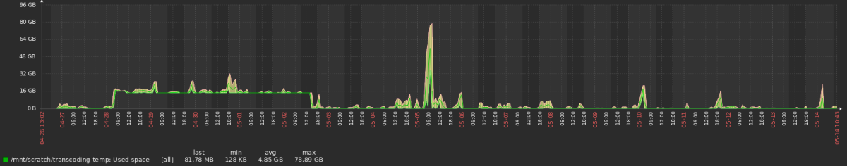

Gabi92 0 Posted May 14, 2024 Author Posted May 14, 2024 24 minutes ago, Lessaj said: From the Transcoding Tab. If you're using an A2000 this is a good page to look at to make sure it's actually able to use it. I don't think you'll wear the SSD before you actually replace it. I've been using the same scratch drive SSDs for years, read and written many many TB both for media preparations as well as transcoding temp files and 0 errors. A drive can still fail at any time of course. I think that you are talking about this option: Habilitar limitación (enable limit) I´ve tried it but same results on ram disk. Also regarding the ram disk, it´s apart from the 3GiB of ram of the machine.
