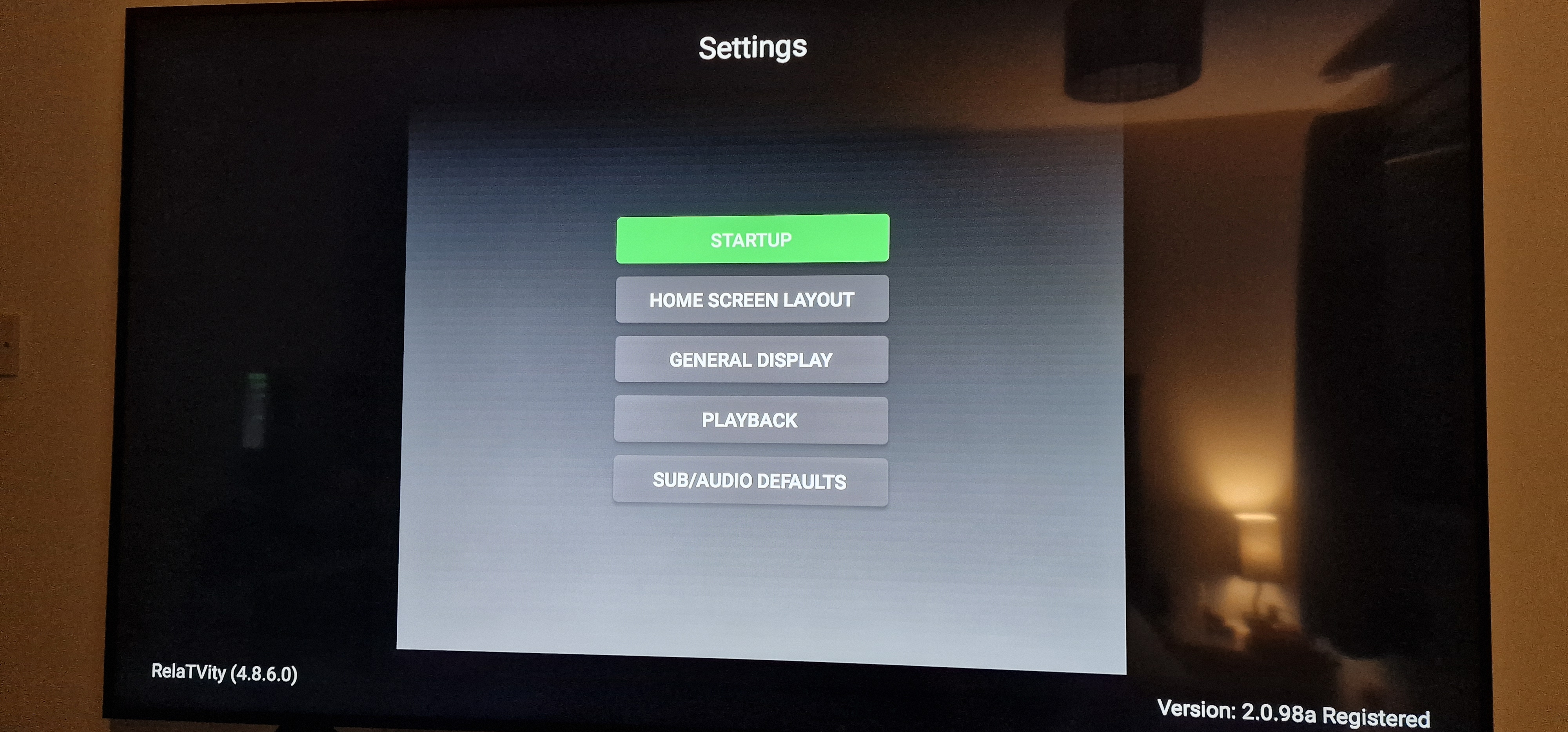

DejaVu77 2 Posted May 15, 2024 Posted May 15, 2024 (edited) The 'Emby' version on Amazon does not have the option to unlock the App. The 'Emby for FireTV' does. The latter is a much older version of the app (v2.9.98a), whereas the 'Emby' app is v3.3.86 doesn't allow an unlock (take my money!) Screenshots from the very, very different UI experiences. The newer one is not unlockable... and I'm begging for it to be on its next release please!! Edited May 15, 2024 by DejaVu77
