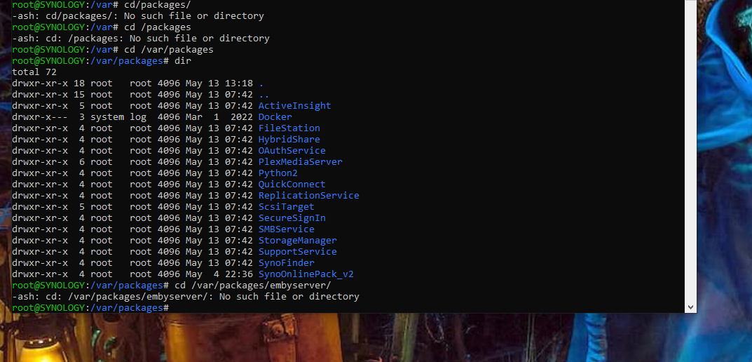

chrisrobbins1970 82 Posted May 13, 2024 Author Posted May 13, 2024 (edited) hmm...after unisntalling from synoligy package center and SSH..there is no embyserver Hoever when I did a reinstall...all settings were there..It did not do a fresh install.. what am I missing? this was the path: Version 4.8.6.0 Folders Program Data - /var/packages/EmbyServer/var Cache - /var/packages/EmbyServer/var/cache Metadata - /var/packages/EmbyServer/var/metadata Logs - /var/packages/EmbyServer/var/logs Transcoding Temporary Files - /var/packages/EmbyServer/var/transcoding-temp Edited May 13, 2024 by chrisrobbins1970
chrisrobbins1970 82 Posted May 13, 2024 Author Posted May 13, 2024 Any help would be great... Emby server folder not available to delete. Any other locations?
chrisrobbins1970 82 Posted May 14, 2024 Author Posted May 14, 2024 (edited) powershell looked under the path /var/packages/EmbyServer/ but it was not there to delete this is what I looked from the emby dashboard to find the location: Version 4.8.6.0 Folders Program Data - /var/packages/EmbyServer/var Cache - /var/packages/EmbyServer/var/cache Metadata - /var/packages/EmbyServer/var/metadata Logs - /var/packages/EmbyServer/var/logs Transcoding Temporary Files - /var/packages/EmbyServer/var/transcoding-temp update: tried with CMD: still same issue NO embyserver folder Edited May 14, 2024 by chrisrobbins1970
chrisrobbins1970 82 Posted May 14, 2024 Author Posted May 14, 2024 I upgraded to DSM7.2 sometime ago.. the Emby Server Data Folder tutorial no longer applies since EmbyServer goes to Program Data - /var/packages/EmbyServer/var but still any ideas?
chrisrobbins1970 82 Posted May 14, 2024 Author Posted May 14, 2024 (edited) OMG..i am SO BLIND..ok cd /volume1/@appdata/EmbyServer do I deleted the whole folder; if so it will not let me.. Had to use rm -r EmbyServer and it removed the directory. NOW the main question... Can I re-install Emby in a folder that I desire?..If not thats OK Edited May 14, 2024 by chrisrobbins1970
