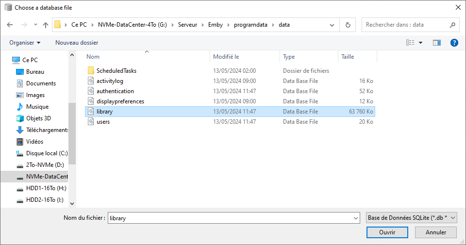

DragoMag 4 Posted May 12, 2024 Posted May 12, 2024 Hello, I hope you are well, I am not very well... To explain quickly, I lost my data due to a format (done by someone else, a technician...) when I should have just reinstalled Windows. He used a custom script, but the script formats all the drives it sees, even though I had specifically mentioned that I only wanted to format my C drive, well, here we are... After 3-4 days I managed to recover a lot of data, but not everything, using MiniTool Power Data Recovery. Fortunately, I was able to restore the Emby server, so I have access to everything that was there before, because it keeps a cache (which is great !). So I was able to see how many movies, series, I had before the incident, etc. What I would like to do now is compare my new Emby (I reinstalled everything to start fresh) with my old one to see what is missing. I looked in the database (library.db) with a software called DB Browser, but found nothing. Can you help me, please ? Thank you VERY much in advance, and have a nice day.

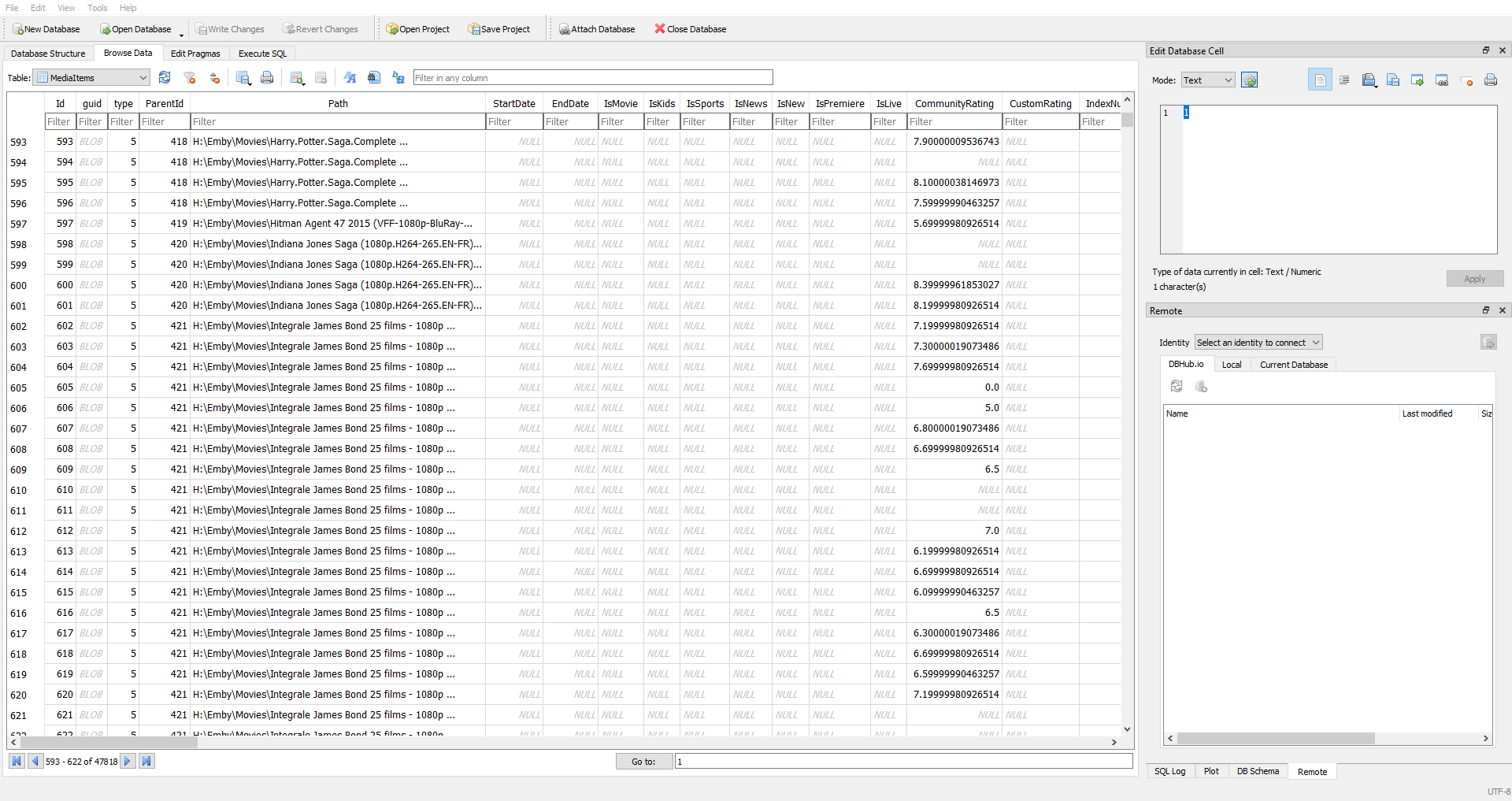

DragoMag 4 Posted May 13, 2024 Author Posted May 13, 2024 I'm currently here : Is there a way to "better" organize?
Luke 42184 Posted May 13, 2024 Posted May 13, 2024 You could add order by path to the end of the query.
DragoMag 4 Posted May 13, 2024 Author Posted May 13, 2024 (edited) I found a way; I type 'movies' (all my movies were in this folder) and I sorted by 'Container' so I only see the files that are in .mkv, .avi etc... and not the subfolders. The issue is that I have about 19 movies that are not in a container but still have an extension. In Emby, I see 598 movies whereas I have 602 In fact, you should be able to search in the search bar for .mkv (etc...) and 'movies' to get everything. Edited May 13, 2024 by DragoMag update
DragoMag 4 Posted May 13, 2024 Author Posted May 13, 2024 I made a SQL code to be able to search :. SELECT * FROM MediaItems WHERE (Path LIKE '%.mkv%' OR Path LIKE '%.mp4%' OR Path LIKE '%.avi%' OR Path LIKE '%.mpegts%') AND Path LIKE '%movies%'; The results are very good 597... one is missing....... 1

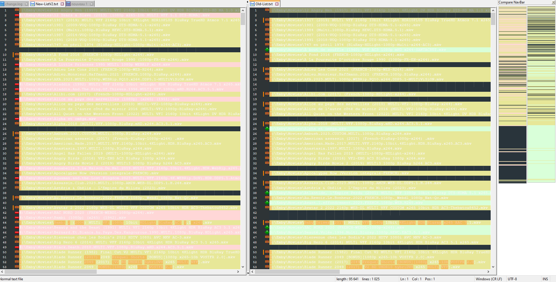

DragoMag 4 Posted May 14, 2024 Author Posted May 14, 2024 Good evening, I'm getting there little by little now, but I have a problem I didn't expect... I can't compare two .txt files : one with my old movies and the other with the current ones (what's left after data recovery). I just want to see the differences and identify what's missing compared to the old server, so I can have a list of what I need to recover to have all my movies back as before.... Could you help me ? Thank you in advance and have a good evening
Lessaj 478 Posted May 14, 2024 Posted May 14, 2024 Sort the lists alphabetically and use Compare plugin on Notepad++?
Lessaj 478 Posted May 15, 2024 Posted May 15, 2024 It's hard to read because of the colour scheme but I think it'll work. Can't really tell since I can't read it.
