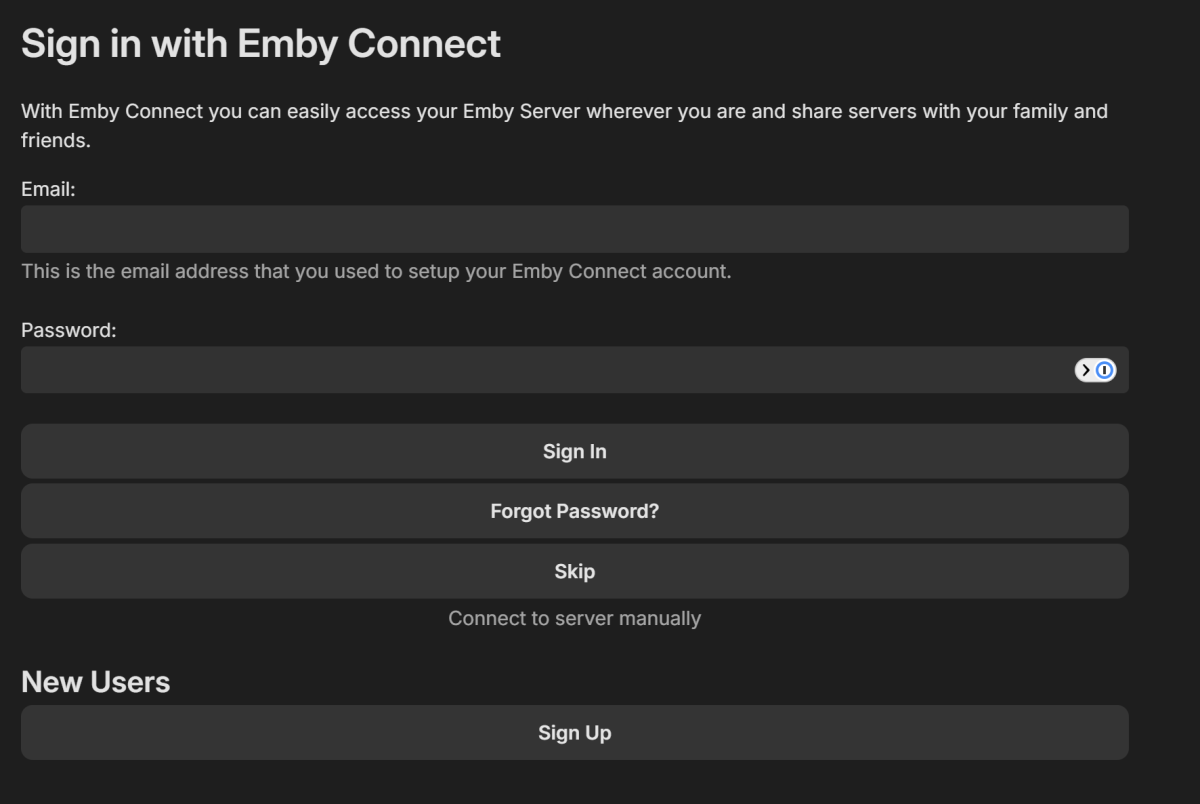

rochambeaux 2 Posted May 12, 2024 Posted May 12, 2024 I've seen older posts but never a solution. I've triple checked the User information on my server and password. Deleted and recreated accounts multiple times. Confirmed the account has my email associated with it. I always end up with "Invalid username or password"
Luke 42242 Posted May 12, 2024 Posted May 12, 2024 Hi there, what does the title of the login screen say?
rochambeaux 2 Posted May 12, 2024 Author Posted May 12, 2024 (edited) Doing the same on Android (connecting through cellular) and WIndows (LAN) Edited May 12, 2024 by rochambeaux
Luke 42242 Posted May 12, 2024 Posted May 12, 2024 OK you said you checked the information on your server, but that’s the Emby connect sign in screen, not your local server sign in. Try clicking skip and then correcting to your server and see if that helps.

rochambeaux 2 Posted May 12, 2024 Author Posted May 12, 2024 7 minutes ago, Luke said: OK you said you checked the information on your server, but that’s the Emby connect sign in screen, not your local server sign in. Try clicking skip and then correcting to your server and see if that helps. That works but isn't Connect to supposed to free me from remembering what my ISP assigned IP address is?

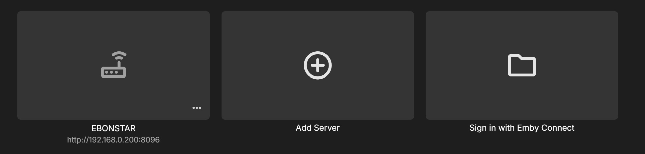

Luke 42242 Posted May 12, 2024 Posted May 12, 2024 2 hours ago, rochambeaux said: OK - why is this happeningl? The server is literally running - I'm watching a show and connected to it via Windows Remote Desktop What if you click add server, what happens then?
Luke 42242 Posted May 12, 2024 Posted May 12, 2024 1 hour ago, rochambeaux said: That works but isn't Connect to supposed to free me from remembering what my ISP assigned IP address is? yes certainly. It's just important to understand the difference between the Emby Connect login and your private server login. They are two different things, and attempting to use the credentials for one on the login screen of the other will result in an error. It sounded like you were trying to use your private server credentials on the Emby Connect login screen.
rochambeaux 2 Posted May 12, 2024 Author Posted May 12, 2024 10 hours ago, Luke said: yes certainly. It's just important to understand the difference between the Emby Connect login and your private server login. They are two different things, and attempting to use the credentials for one on the login screen of the other will result in an error. It sounded like you were trying to use your private server credentials on the Emby Connect login screen. Thanks - I understand that you create the username/password for local access on the server but where are the Emby Connect credentials stored/maintained? I've tried "mirroring" my username and password everywhere I could find on anything "Emby" and still seem to have this disconnect. In the example above I was trying to connect to the Emby site and that windows with the 3 options popped up. When I try to use the credentials I had just updated on server it came back with the error. It feels like I'm being forced to log into "Connect" but I can because I don't have the correct credentials but to change them I need to login - vicious circle.
pwhodges 2033 Posted May 12, 2024 Posted May 12, 2024 2 hours ago, rochambeaux said: Thanks - I understand that you create the username/password for local access on the server but where are the Emby Connect credentials stored/maintained The Connect login is the login for this forum. Paul
rochambeaux 2 Posted May 13, 2024 Author Posted May 13, 2024 5 hours ago, pwhodges said: The Connect login is the login for this forum. Paul Interesting. I can log in here but if I try the same credentials for the Android App it doesn't work
Luke 42242 Posted May 13, 2024 Posted May 13, 2024 20 hours ago, Luke said: What if you click add server, what happens then? Hi, did you try this?
rochambeaux 2 Posted May 13, 2024 Author Posted May 13, 2024 5 minutes ago, Luke said: Hi, did you try this?
Lessaj 484 Posted May 13, 2024 Posted May 13, 2024 Did you try the third bullet point? Your browser might be redirecting you to https.

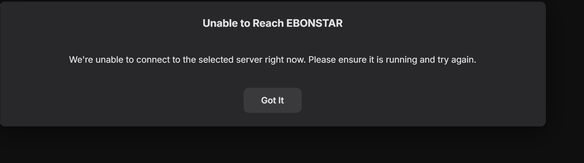

Luke 42242 Posted May 13, 2024 Posted May 13, 2024 1 hour ago, rochambeaux said: OK so when you get the unable to reach server error, this is the reason why you can't connect. What you will need to do is choose one of these four options. Please let us know if this helps. Thanks.

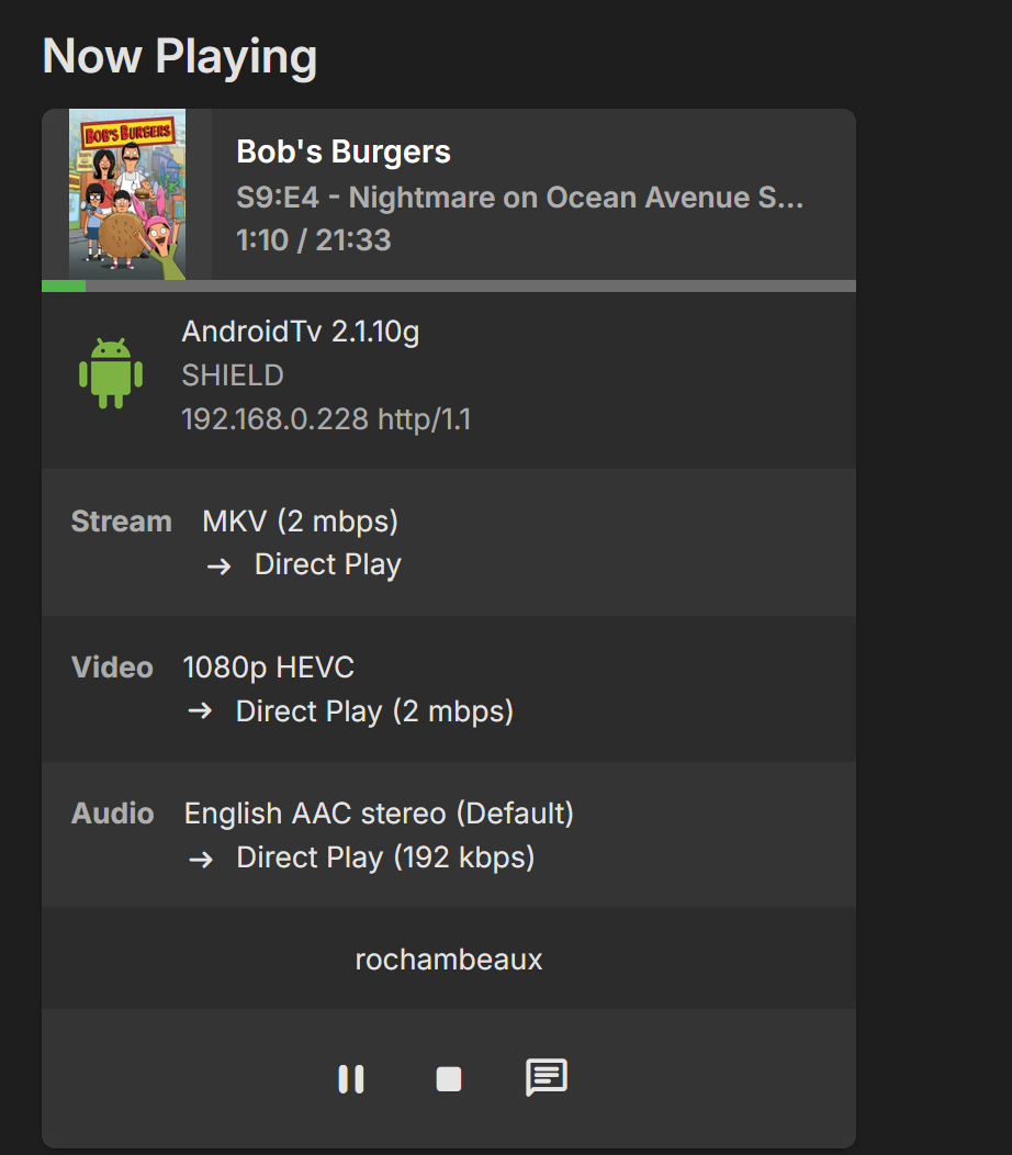

rochambeaux 2 Posted May 13, 2024 Author Posted May 13, 2024 2 hours ago, Luke said: OK so when you get the unable to reach server error, this is the reason why you can't connect. What you will need to do is choose one of these four options. Please let us know if this helps. Thanks. I don't understand the error. The server is running on my home LAN - I can reach it via Windows remote desktop. I have drives on it mapped and can access those. My ShieldTV is streaming content from it to a TV.
Luke 42242 Posted May 13, 2024 Posted May 13, 2024 1 minute ago, rochambeaux said: I don't understand the error. The server is running on my home LAN - I can reach it via Windows remote desktop. I have drives on it mapped and can access those. My ShieldTV is streaming content from it to a TV. It’s not an issue of reachability. It’s an issue of browser requirements and restrictions for https. When you use the hosted web app over https, the browser will not allow you to connect to your Emby server over plain http. They just don’t allow that anymore. so that’s not a bug per se but rather that you have to pick one of the four options in the bullet points.
