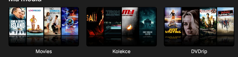

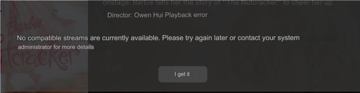

Houfino 41 Posted May 11, 2024 Posted May 11, 2024 (edited) Hi...About 1-2 months ago it was working and now it's not.I think the update is to blame.....Only dvdrip doesn't work.....Only 720p or 1080p works...Why? Explain to me..Thank you Movies - WORKS DVDrip - doesn't work Emby version: 4.8.6.0 DSM 7.1.1-42962 Update 5 ffmpeg-directstream-89c2ecfe-2db8-439d-b1ca-999f84179846_1.txt ffmpeg-directstream-a141ad6f-adf5-4697-b740-a11228ba96e0_1.txt embyserver.txt ffmpeg-directstream-4a923bd7-5983-4e5a-8a04-a1488563750e_1.txt ffmpeg-directstream-9dd1d50b-5935-4c23-a9b2-f9b7dc9e8228_1.txt Edited May 11, 2024 by Houfino
Houfino 41 Posted May 11, 2024 Author Posted May 11, 2024 Next...Why did it stop working???????????? I do not understand I didn't set at all... embyserver.txt ffmpeg-directstream-498a9164-5200-417e-a982-9627a1df509e_1.txt ffmpeg-directstream-16735a76-aab5-4bd1-99a5-02601a296f87_1.txt ffmpeg-directstream-a8d391ca-6457-449a-a946-b639f09b4532_1.txt

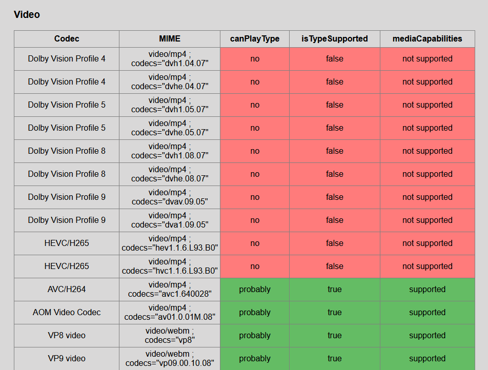

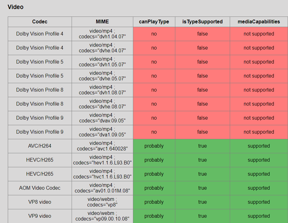

Happy2Play 9811 Posted May 11, 2024 Posted May 11, 2024 (edited) Can only guess because your option physically brake playback, conditionally may need more then container change. Enable Playback Remuxing: True Enable Video Playback Transcoding: False Enable Audio Playback Transcoding: False As HEVC appears to not be supported in the browser. &VideoCodec=h264,av1 What does codec support (dolby.com) show? My FireFox My Edge browser Edited May 11, 2024 by Happy2Play

Happy2Play 9811 Posted May 11, 2024 Posted May 11, 2024 No as you cannot play HEVC in a client/hardware that does not support it. You have to enable transcoding options on the user. Unless you can show a specific example that should work but so far you have provided examples that will not play without conversion as already shown above. 4 minutes ago, Houfino said: Too bad you can't go back to older versions...I'm out of luck This is why user backups are a required management plan. But yes this is a little more complicated per choice of platforms.

Happy2Play 9811 Posted May 12, 2024 Posted May 12, 2024 The browser does not support hevc and require full conversion, but your hardware just cannot handle the task fast enough. As there is a difference between first post of failing do to settings and last of processing media slowly. Does media that is not HEVC plays correctly? Or you need a different client as Firefox will require transcoding. Did you test its capabilities per the link I provided? Everything looks normal to me.
