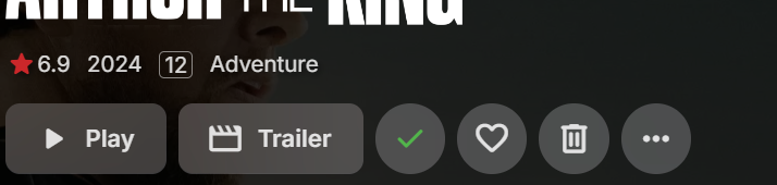

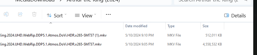

I am still intermittently having playback issues with certain downloaded files.
When I looked at the logs I see an error about max bitrate being exceeded.
If I use a multiplex app (like MKVToolNix) I can get the file to play.  Also Emby seems to have an issue "reading" the file because in the file screen it doesn't show info for the file , vs where the multiplexed version gives correct info.
You think there is a fix?   Are Radarr download options possibly not set correctly?  Thoughts?

 seems that Emby doesn’t like encoding on some files that I download through Sonarr and Radarr.  They are mkv files.   It’s like it had trouble reading them.  If I  had some automated way to multi Plex the files I would
