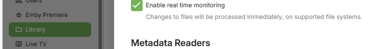

Luke 42243 Posted February 26, 2025 Posted February 26, 2025 OK do you have the realtime monitor enabled on any of your libraries? That would be one thing to try turning off.
appas 3 Posted February 26, 2025 Author Posted February 26, 2025 7 hours ago, Luke said: OK do you have the realtime monitor enabled on any of your libraries? That would be one thing to try turning off. How do I check that? But no, I haven't at least manually set anything like that, so unless it's the default, I'd say the answer is no.
sa2000 697 Posted February 26, 2025 Posted February 26, 2025 51 minutes ago, appas said: I haven't at least manually set anything like that, so unless it's the default, I'd say the answer is no. Real Time Monitoring for libraries is enabled by default when creating a library. You can see the option when you open server settings and go to Library settings and view/edit each library settings Are you sure the Emby Server process is being killed ? and have you found out what memory usage is whilst running ? The log shows loads of very slow database transactions and requests that are taking a long time to complete - suggesting some system / disc issue perhaps This shows requests that took more than 10 seconds in last log file - pasting timestamp, elapsed seconds to complete and the request url Time Elapsed Time URL 2025-02-25 22:21:49.869 23.72 GET /emby/Items/70396/Images/Primary?maxHeight=80&maxWidth=80&tag=5c0386d0108c7dd6eae9bc6dc7eed0fa&quality=90 2025-02-25 22:21:49.874 23.714 GET /emby/Items/64927/Images/Primary?maxHeight=80&maxWidth=80&tag=9974f9b89aa9a15bc3df834c384606aa&quality=90 2025-02-25 22:21:50.367 23.37 GET /emby/Items/67577/Images/Primary?maxHeight=80&maxWidth=80&tag=6e03e6d482a72e3543a79b24b1ac9105&quality=90 2025-02-25 22:21:50.370 23.219 GET /emby/Items/67589/Images/Primary?maxHeight=80&maxWidth=80&tag=54e6a7b598079ba6d266352b3deaf7ce&quality=90 2025-02-25 22:21:50.517 23.073 GET /emby/Items/67602/Images/Primary?maxHeight=80&maxWidth=80&tag=c6ffa11a66cf6f75ec12ef0cfb0b88f8&quality=90 2025-02-25 22:21:50.527 23.204 GET /emby/Items/67618/Images/Primary?maxHeight=80&maxWidth=80&tag=02251347d44af3e80e888029765ec071&quality=90 2025-02-25 22:22:13.729 108.39 GET /emby/Users/f1bf8161106d4fe68fb3469fdf9757d5/Items?Fields=PrimaryImageAspectRatio&Recursive=true&IncludeItemTypes=Playlist&X-Emby-Client=Emby Web&X-Emby-Device-Name=Chrome&X-Emby-Device-Id=TW96aWxsYS81LjAgKFgxMTsgTGludXggeDg2XzY0KSBBcHBsZVdlYktpdC81MzcuMzYgKEtIVE1MLCBsaWtlIEdlY2tvKSBDaHJvbWUvMTMyLjAuMC4wIFNhZmFyaS81MzcuMzZ8MTc0MDMzNDk3MjkzMw11&X-Emby-Client-Version=4.8.10.0&X-Emby-Language=en-us 2025-02-25 22:22:13.890 65.876 GET /emby/Users/f1bf8161106d4fe68fb3469fdf9757d5/Items/Latest?Limit=16&Fields=BasicSyncInfo,CanDelete,PrimaryImageAspectRatio,ProductionYear,Status,EndDate&ImageTypeLimit=1&EnableImageTypes=Primary,Backdrop,Thumb&ParentId=6&X-Emby-Client=Emby Web&X-Emby-Device-Name=Chrome&X-Emby-Device-Id=TW96aWxsYS81LjAgKFgxMTsgTGludXggeDg2XzY0KSBBcHBsZVdlYktpdC81MzcuMzYgKEtIVE1MLCBsaWtlIEdlY2tvKSBDaHJvbWUvMTMyLjAuMC4wIFNhZmFyaS81MzcuMzZ8MTc0MDMzNDk3MjkzMw11&X-Emby-Client-Version=4.8.10.0&X-Emby-Language=en-us 2025-02-25 22:22:22.241 57.529 GET /emby/Items/67630/Images/Primary?maxHeight=80&maxWidth=80&tag=d0ba6f5a37581b488c372649d14b5810&quality=90 2025-02-25 22:22:22.490 58.496 GET /emby/Items/67641/Images/Primary?maxHeight=80&maxWidth=80&tag=c671f8d64d6e6d2ce925a89ef2982de3&quality=90 2025-02-25 22:22:25.403 17.748 GET /emby/ScheduledTasks?isHidden=false&X-Emby-Client=Emby Web&X-Emby-Device-Name=Chrome&X-Emby-Device-Id=TW96aWxsYS81LjAgKFgxMTsgTGludXggeDg2XzY0KSBBcHBsZVdlYktpdC81MzcuMzYgKEtIVE1MLCBsaWtlIEdlY2tvKSBDaHJvbWUvMTMyLjAuMC4wIFNhZmFyaS81MzcuMzZ8MTc0MDMzNDk3MjkzMw11&X-Emby-Client-Version=4.8.10.0&X-Emby-Language=en-us 2025-02-25 22:22:43.266 36.509 GET /emby/System/Logs/Query?IncludeItemTypes=Log&Fields=BasicSyncInfo,CanDelete,PrimaryImageAspectRatio,ProductionYear,Status,EndDate,CommunityRating,OfficialRating,CriticRating&StartIndex=0&EnableImageTypes=Primary,Backdrop,Thumb&ImageTypeLimit=1&Recursive=true&Limit=30&X-Emby-Client=Emby Web&X-Emby-Device-Name=Chrome&X-Emby-Device-Id=TW96aWxsYS81LjAgKFgxMTsgTGludXggeDg2XzY0KSBBcHBsZVdlYktpdC81MzcuMzYgKEtIVE1MLCBsaWtlIEdlY2tvKSBDaHJvbWUvMTMyLjAuMC4wIFNhZmFyaS81MzcuMzZ8MTc0MDMzNDk3MjkzMw11&X-Emby-Client-Version=4.8.10.0&X-Emby-Language=en-us Looking at the slow db queries, this is one that took over 6 seconds select A.type,A.Id,A.StartDate,A.EndDate,A.IsMovie,A.IsSeries,A.IsKids,A.IsSports,A.IsNews,A.IsRepeat,A.IsNew,A.IsPremiere,A.IsLive,A.CommunityRating,A.CustomRating,A.IndexNumber,A.IsLocked,A.PreferredMetadataLanguage,A.PreferredMetadataCountryCode,A.Width,A.Height,A.DateLastRefreshed,A.Name,A.Path,A.PremiereDate,A.Overview,A.ParentIndexNumber,A.ProductionYear,A.OfficialRating,A.SortName,A.RunTimeTicks,A.Size,A.Container,A.DateCreated,A.DateModified,A.guid,A.ParentId,A.IsInMixedFolder,A.DateLastSaved,A.LockedFields,A.OriginalTitle,A.CriticRating,A.SeriesName,A.Album,A.AlbumId,A.SeriesId,A.PresentationUniqueKey,A.Tagline,A.ProviderIds,A.Images,A.ProductionLocations,A.TotalBitrate,A.ExtraType,A.ExternalId,A.SeriesPresentationUniqueKey,A.Status,A.DisplayOrder,A.ThreeDFormat,A.RemoteTrailers,A.SortIndexNumber,A.SortParentIndexNumber,A.IndexNumberEnd,A.IsPublic from MediaItems A where A.ParentId=30809 You could find out what this relates to and run it in sqlite browser or sqlite studio with emby server shutdown, opening the db file /var/lib/emby/data/library.db you can do the following to see what this relates to select id, name from MediaItems where ParentId=30809; select id, name from MediaItems where Id=30809;
