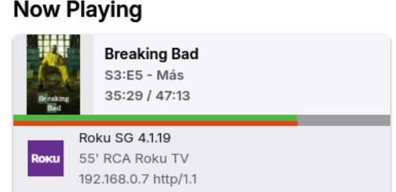

electricwildflower 17 Posted May 9, 2024 Author Posted May 9, 2024 Here is a screenshot of an episode playing on the dashboard, and one of both transcoding and network. My current hardware specs of the Truenas server are. Motherboard - MSI 990FXA GAMING Socket AM3+ motherboard Processor - AMD FX 8350 8 core processor Ram - DDR3 32GB Graphics Card - Radeon RX 580 Power Supply - 1000 Watt OS - Truenas Scale Bluefin latest version Ethernet - Onboard Emby is installed from the Truecharts repository by just opening up apps on Truenas Scale, searching for Emby and installing the Truecharts version adding the relevant info for media shares etc. Most video's that i have played where working fine till i got this new Roku TV and then had to upgrade some of the Movies & TV series to better qualities. The problem started about a week or 2 ago or more. Hopefully it's just a network issue that i'll resolve.
Lessaj 484 Posted May 9, 2024 Posted May 9, 2024 Yes it's transcoding because of a quality setting, I think it pretty much defaults to 4 Mbps on auto. I'd recommend either manually setting a higher quality or see if putting 192.168.0.0/24 in the LAN networks field and probably restart the client app if that works to play at full quality and hopefully also doesn't transcode. It's not using your RX 580 at all. 1
