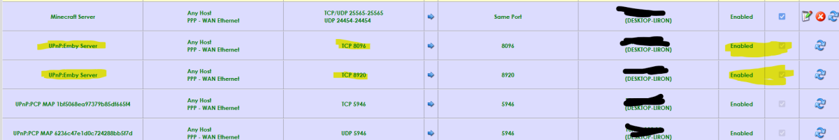

Liron_ 1 Posted May 8, 2024 Posted May 8, 2024 i created an emby server and it auto created ports in my router now i cant disable them nor remove them and i want to use another program since im switching to another machine but i still want to use the same ports but even if not the same ports i dont want just extra ports open for access from the outside since that isnt secure. how can i delete them and my server completely?

darkassassin07 669 Posted May 8, 2024 Posted May 8, 2024 Disable UPnP (Universal Plug and Play) in your routers settings. It allows devices on your lan to create port forwarding rules automatically.

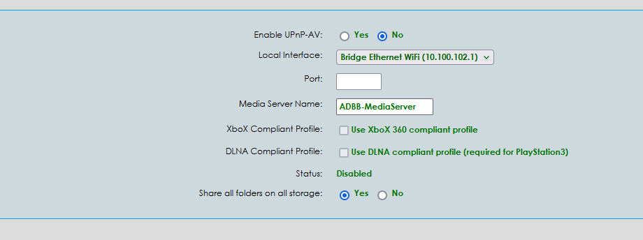

Liron_ 1 Posted May 8, 2024 Author Posted May 8, 2024 do you have any idea where i could find it? ik every router web page is different but a general idea where it could be?
Liron_ 1 Posted May 8, 2024 Author Posted May 8, 2024 i think i found it yet i still cant change anything
Happy2Play 9798 Posted May 8, 2024 Posted May 8, 2024 21 minutes ago, Liron_ said: how can i delete them and my server completely? Must be another options somewhere but from a Emby standpoint just uninstall the port mapper plugin and restart server and router. If you have already uninstalled Emby then restart your router.
Solution Liron_ 1 Posted May 8, 2024 Author Solution Posted May 8, 2024 (edited) it worked thank you i just needed to restart my router edit: disable UPnP and restart router after uninstalling Edited May 8, 2024 by Liron_ 1
