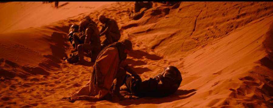

sh0rty 730 Posted May 31, 2024 Posted May 31, 2024 (edited) 6 hours ago, softworkz said: Which client? Emby Theater latest on the same machine as Emby Server latest stable. Techspecs are in my signature. PC is connected to 3 1080p non-HDR displays from Acer (2xDP, 1x HDMI). Like I initially said, I guess a simple setting or checkbox in the client additionally to the auto mechanisms in Emby, no matter if it's Theater, Android etc., that tells the server "hey my connected display is not HDR capable", so that the server transcodes in any case with tonemapping would be awesome. Edited May 31, 2024 by shorty1483

sh0rty 730 Posted June 1, 2024 Posted June 1, 2024 16 hours ago, softworkz said: If you choose gpuNext for the VO setting of the player, doesn't the player do the tone mapping then? No, gpu-next setting doesn't make any difference. File direct plays also in this mode.
softworkz 5135 Posted June 1, 2024 Posted June 1, 2024 1 hour ago, shorty1483 said: No, gpu-next setting doesn't make any difference. File direct plays also in this mode. Yes of course, but doesn't it do client-side tone mapping in that case?
sh0rty 730 Posted June 1, 2024 Posted June 1, 2024 (edited) 2 hours ago, softworkz said: Yes of course, but doesn't it do client-side tone mapping in that case? You tell me. Not really familiar with the differences. What I can say is, that the picture looks different between gpu-next and auto. Force transcoding with Reinhardt Tonemapping and video output set to gpu-next in Theater: Direct play with video output set to gpu-next in Theater: Direct play with video output set to Auto in Theater: Edited June 1, 2024 by shorty1483

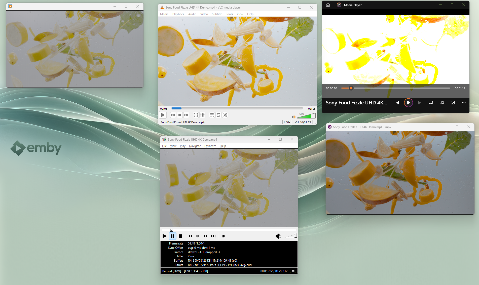

softworkz 5135 Posted June 2, 2024 Posted June 2, 2024 This appears to me as if all of them would be tone-mapped, because non-tonemapped would normally rather have less contrast than the Reinhhardt tone mapping. Let's maybe use some commonly known video like "sony food fizzle 4kmedia" (google). Unfortunately, tone mapping is not something like a defined and predictive procedure. For the mentioned video, here's a comparison: Left top and center bottom: Not tone mapped (classic windows media player and MPC HC) Center top and right bottom: tone mapped in two different ways (VLC and MPV) Right top: Probably bug, causing over-exposure (Windows Media Player)
sh0rty 730 Posted June 3, 2024 Posted June 3, 2024 On 6/2/2024 at 1:00 PM, softworkz said: This appears to me as if all of them would be tone-mapped, because non-tonemapped would normally rather have less contrast than the Reinhhardt tone mapping. Let's maybe use some commonly known video like "sony food fizzle 4kmedia" (google). Unfortunately, tone mapping is not something like a defined and predictive procedure. For the mentioned video, here's a comparison: Left top and center bottom: Not tone mapped (classic windows media player and MPC HC) Center top and right bottom: tone mapped in two different ways (VLC and MPV) Right top: Probably bug, causing over-exposure (Windows Media Player) Is there any client log in Theater where I could check out whats going on the client end?
softworkz 5135 Posted June 3, 2024 Posted June 3, 2024 3 minutes ago, shorty1483 said: Is there any client log in Theater where I could check out whats going on the client end? No, but the new Emby Theater Windows will have client-side logs. 1
