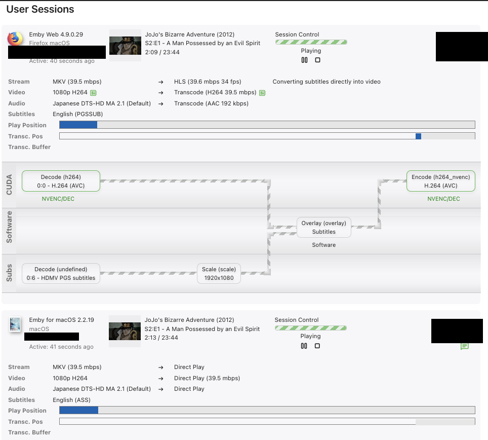

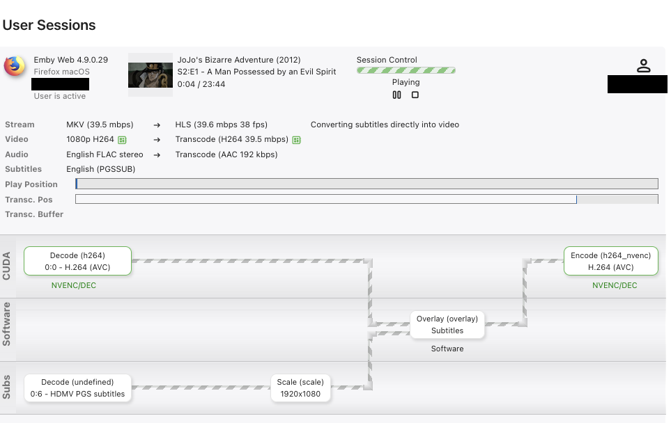

guunter 49 Posted August 10, 2024 Posted August 10, 2024 1 hour ago, pwhodges said: I've downloaded that exact file (specifically, s02e01). It only has 7 subtitle streams, which is no big deal - some are ASS and some are PGS. The video bit rate is 37Mbps with another 2Mbps for the audio, which is high for an anime, and the default audio is 2.1 [sic] DTS-MA. I can't see anything odd about the ASS subs (they're quite intensive in their effects, but once they play, they play fine). It direct-plays with no issues on iOS 2.2.27 and Android 3.4.20. Playing in the Web client I got the same as the OP - the first attempt to play (with DTS audio and ASS subs) just hung, and then said no compatible streams; but then I tried with PGS and it played OK, and following that the ASS subs played OK as well (both burning in at the server for the web client). I can't repeat the initial issue right now; I presume the transcode has been cached and I need to kill it somehow before I can test what happens when the first play uses either PGS subs or the alternate Flac audio. The experiment started at 20:43 in the attached logs. Paul logs.zip 176.36 kB · 0 downloads My experience was the same as ep1. The .ass will not work on the web client but PGS does. Emby on MacOS was able to direct play everything PGS and .ass. Didn't download the log but here's a SS of the user session. FLAC also works fine. And with FLAC on web.
Riptide126 24 Posted August 10, 2024 Author Posted August 10, 2024 Is it possible that my RAM could be the issue, I only have 16gb at 2133mhz
Riptide126 24 Posted August 10, 2024 Author Posted August 10, 2024 1 hour ago, guunter said: My experience was the same as ep1. The .ass will not work on the web client but PGS does. Emby on MacOS was able to direct play everything PGS and .ass. Didn't download the log but here's a SS of the user session. FLAC also works fine. And with FLAC on web. I just tested, the pgs work for me as well, its just the .ass that doesnt work, let me try on another device and see if I get the issue 1

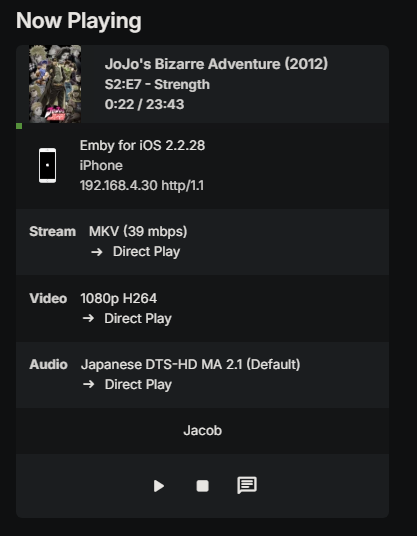

Riptide126 24 Posted August 14, 2024 Author Posted August 14, 2024 Sorry for the delay, I just tried it on my iphone and it started playing instantly, no buffering no delay. I have attached the logs and a picture of the playback, looks like it was direct play. I was also on my local network when I tested it. embyserver.txt 1
