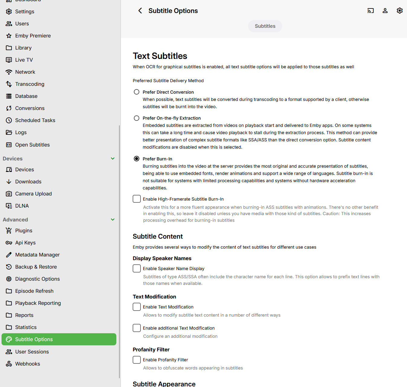

guunter 49 Posted August 9, 2024 Posted August 9, 2024 With anime which uses .ass I had to switch to burning in subtitles. If you download the diagnostic plugin you get more subtitle options in advanced. I’d turn off subtitle extraction in transcoding and then select burn in subtitles in subtitle options. Just fyi it’ll will burn in subtitles using your cpu but a 7700k should be fine.

guunter 49 Posted August 9, 2024 Posted August 9, 2024 1 hour ago, Riptide126 said: I already have it set to those settings, I had the same issues because when I had subtitle extraction on the fly it just wouldnt display the subtitles at all, so I switched to forced burn in in the diagnostic options and disabled on the fly. I'm not talking about the diagnostic tab. You shouldn't mess with those they don't persist on a restart. I'm talking about this
Riptide126 24 Posted August 10, 2024 Author Posted August 10, 2024 Yeah thats what I was talking about, sorry I got confused because you said diagnostic plugin, I havent touched the diagnostic tab
