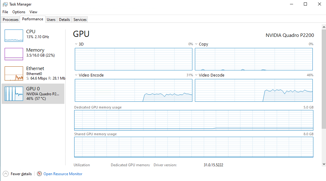

cyris69 2 Posted May 6, 2024 Posted May 6, 2024 (edited) So I've migrated my emby server to a better machine which I could finally install a P2200 in. I'm running ESXi 8.0.2 and the emby server is on a Windows 2022 Server VM. The GPU is passed through and drivers installed on the OS. The GPU works fine in the VM. When I play a 4k movie that is direct play but not the audio it still populates a newly created folder in the transcoding-temp folder with a m3u8 and .ts files. Web will show: So it's not using the GPU which is fine as it's not video. However, if I try and change the stream to 1080p it will timeout. It will just keep creating and removing folders inside the temp then say there is no available stream. You can see the Video Decode on the machine blips each time it tries this Emby Hardware encoding detects the GPU Logs for the transcode doesn't show any errors that I can tell ffmpeg-transcode-2fa1e140-9b2f-4343-9ffe-7e3c2174ab73_1.txt Edited May 6, 2024 by cyris69 removed image

cyris69 2 Posted May 6, 2024 Author Posted May 6, 2024 Decided to run it again to get a fresh log since I was messing around with other movies. This time it did around 10 blips then actually started. You can see the blips in the middle left of the screenshot then started working. Took at least a minute of sitting before starting to play. Here are the logs anyways to see why there is such a delay and several attempts. ffmpeg-transcode-0ac814c9-8cd2-4e1b-9230-6c0e5664f819_1.txt embyserver.txt
Lessaj 478 Posted May 6, 2024 Posted May 6, 2024 Looks like each attempt to run the ffmpeg failed after 10 seconds but there's no indication in the server log for why, there might be more information in each of the ffmpeg logs since every attempt will create a new log. 1
