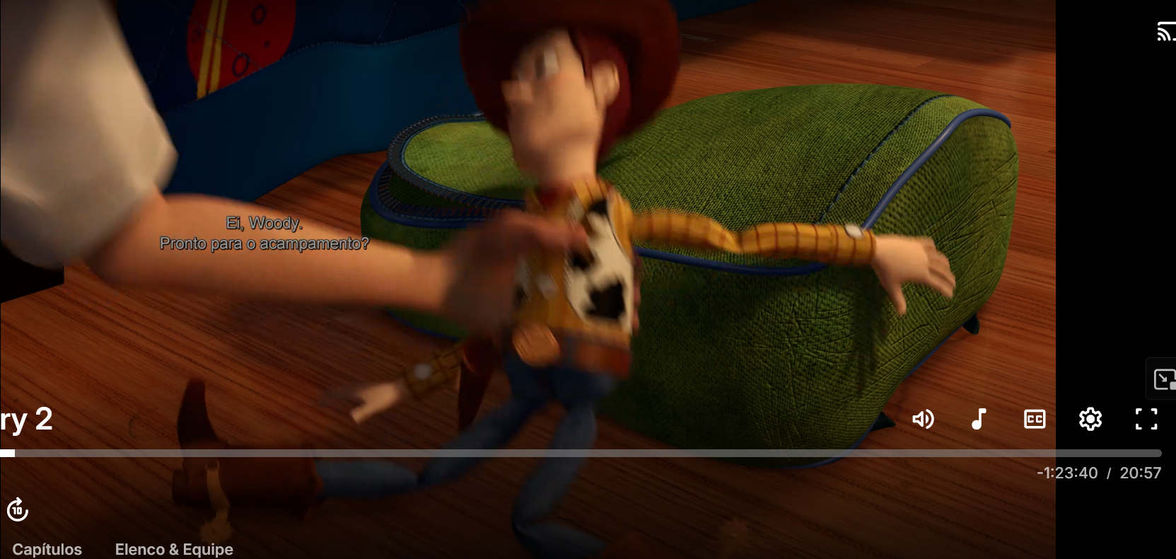

igorbr 7 Posted May 6, 2024 Author Posted May 6, 2024 In this image you can see the subtitle on the left middle position
sa2000 697 Posted May 6, 2024 Posted May 6, 2024 (edited) Could you please provide server logs when you see the issue of missing subtitles and provide the media info as well See this article relating to the logs and playback issues reporting Are you able to get me a clip from one of these media files with the subtitles where it is not working. Also info which device/app / version the playback was on and if the same issues arises on different clients, When providing clips/samples please zip and upload externally and send me a link to download the zip With regards to the other issue of the position of the subtitles, which client app/version/device was this on and is the problem occurring on multiple apps Edited May 6, 2024 by sa2000
igorbr 7 Posted May 6, 2024 Author Posted May 6, 2024 (edited) Hi, Thanks for your reply. Logs attached for the video executing time, was a very short time to keep the logs clean. During the execution the subtitle was small on the middle left area of the screen so I set subtitle off and on again but no lucky. About the device, it happens everywhere I already tested multiple browsers, computers, phones and also with the emby theater for windows About the video, it is a very large file and I don't have any tool to cut it in hand now, but I think it would not help because the problem is happening with multiple files, anyway let me show you some info about one of the videos: Informações da Mídia /mnt/nas/midia/filmes/Toy.Story.2.(1999).4K.UHD.Remux.2160p.h265.Dual.Audio.ROBSON2015/Toy.Story.2.(1999).4K.UHD.Remux.2160p.h265.Dual.Audio.ROBSON2015.mkv MKV38,2 GBAdicionado 24/04/2024 12:09 Vídeo Título4K HDR 10 HEVC CodecHEVC PerfilMain 10 Nível153 Resolução3840x2160 Proporção da imagem16:9 EntrelaçadoNão Framerate23,976 Taxa59 mbps Faixa de vídeoHDR 10 Cores primáriasbt2020 Espaço da corbt2020nc Transferência da corsmpte2084 Bit da imagem10 bit Formato do pixelyuv420p10le Quadros de referência1 Áudio TítuloEnglish TRUEHD 7.1 Título EmbutidoTrueHD Atmos 7.1 IdiomaEnglish CodecTRUEHD Layout7.1 Canais8 ch Taxa da amostra48.000 Hz Bit da imagem24 bit PadrãoNão Legenda TítuloPortuguese (PGSSUB) Título EmbutidoPortuguese (Brazilian) IdiomaPortuguese CodecPGSSUB PadrãoNão ForçadaNão Deficientes AuditivosNão ExternoNão Edited May 6, 2024 by Abobader Removing logs
Solution igorbr 7 Posted May 6, 2024 Author Solution Posted May 6, 2024 I just found that the problem is with PGSSUB. I tested with SRT and everything works fine.
Happy2Play 9812 Posted May 6, 2024 Posted May 6, 2024 Yes currently a known issue in HWA and PGSSUB. There are actually several topics but it is a scaling issue. 1
