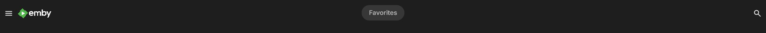

goobee01 1 Posted May 6, 2024 Author Posted May 6, 2024 Sorry, I called it the left panel but it's most likely not called that. In the pictures below, you can see what it looks like now vs what it looks like before the upgrade. On the current version, the Admin functions don't show. If I am understanding your question correctly, I hid everything on the top of the page. Using http://localhost:8096/web/index.html#!/dashboard doesn't help, it just brings me to the log in page. I'm guessing that I will need to reinstall from scratch then?
Happy2Play 9811 Posted May 6, 2024 Posted May 6, 2024 24 minutes ago, goobee01 said: Using http://localhost:8096/web/index.html#!/dashboard doesn't help, it just brings me to the log in page. I'm guessing that I will need to reinstall from scratch then? Okay yes drawer options have been removed per all the redundancy (drawer, user icon, gear). No you still have options but what if you went to the connection you already have ie http://192.168.0.5:8096/web/index.html#!/dashboard (unauthenticated sessions will bounce to login screen so you would reauthenticate and go to dashboard url if using localhost) But have you brought up the browser console and selected a near element to get to actual hidden element as shown in image? To me that would be the easiest route but will need a understanding of that console. Last resort delete/edit the branding.xml and restart Emby. path will be platform prevalent. C:\Users\username\AppData\Roaming\Emby-Server\programdata\config\branding.xml
