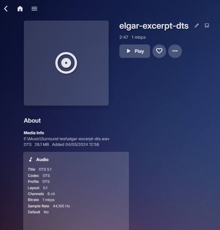

pwhodges 2023 Posted May 4, 2024 Posted May 4, 2024 But this is extracting from a CD, not a DVD or BD, so getting a WAV file is to be expected. If the track actually contains DTS and has not been altered in any way (e.g. dither, gain normalisation, or topping and tailing) then it will play as multi-channel DTS in just about any player, such as VLC. The DTS track has a header which switches the DTS decoder on As part of my early testing of Emby I took a DTS track from a DTS CD I made nearly 20 years ago and saved it as a wav file with a WAV extension, and also with a DTS extension - I even made an MKA containing it. These all play in Emby generating the correct four-channel output (well, six with two empty). I don't recall clearly, but it might have failed initially, and got fixed when I reported it. Here is Emby's view - note, this is a two-channel WAV file, but Emby has correctly identified the DTS content: Paul 1
rbjtech 5335 Posted May 4, 2024 Posted May 4, 2024 1 hour ago, pwhodges said: But this is extracting from a CD, not a DVD or BD, so getting a WAV file is to be expected. If the track actually contains DTS and has not been altered in any way (e.g. dither, gain normalisation, or topping and tailing) then it will play as multi-channel DTS in just about any player, such as VLC. The DTS track has a header which switches the DTS decoder on As part of my early testing of Emby I took a DTS track from a DTS CD I made nearly 20 years ago and saved it as a wav file with a WAV extension, and also with a DTS extension - I even made an MKA containing it. These all play in Emby generating the correct four-channel output (well, six with two empty). I don't recall clearly, but it might have failed initially, and got fixed when I reported it. Here is Emby's view - note, this is a two-channel WAV file, but Emby has correctly identified the DTS content: Paul Sure Paul - I'm not disagreeing. Good to know emby is detecting as DTS (ffmpeg I guess).

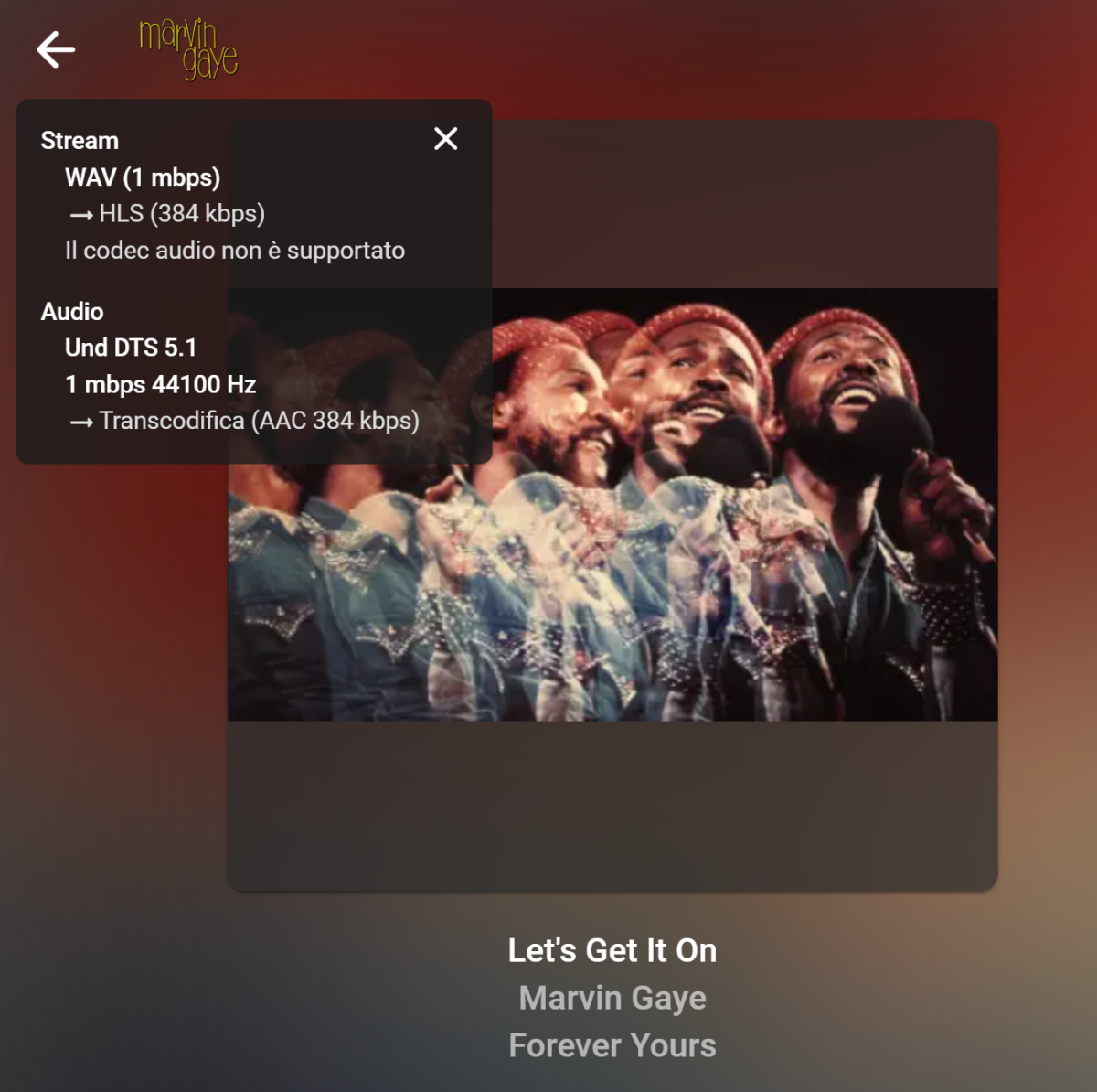

pwhodges 2023 Posted May 5, 2024 Posted May 5, 2024 Hang on; I just realised that your image shows Emby transcoding the file - in my tests I think it was always being direct played. The A/V amp is not getting the DTS but the AAC transcode, which is why the indicator is not showing. This is because you are sending it through the TV, which Emby reckons can't handle either the WAV format or the DTS content (I'm not sure which). If you can provide the logs for this playback (ffmpeg as well as Emby), it might be possible to work out the exact cause. Paul
Pietrogramma 3 Posted May 5, 2024 Author Posted May 5, 2024 (edited) 2 hours ago, pwhodges said: Hang on; I just realised that your image shows Emby transcoding the file - in my tests I think it was always being direct played. The A/V amp is not getting the DTS but the AAC transcode, which is why the indicator is not showing. This is because you are sending it through the TV, which Emby reckons can't handle either the WAV format or the DTS content (I'm not sure which). If you can provide the logs for this playback (ffmpeg as well as Emby), it might be possible to work out the exact cause. Paul I think it's exactly as you say. Consider that I have a TCL TV, on which I have installed Emby app, which takes files from my NAS. The TV is connected to the amplifier via optical cable. For movies and concerts in DTS or DD (*.mkv files) everything is ok, the amplifier reproduces them perfectly in DTS or DD, only for these files ripped from CD/DTS I have problems. I attach the log file ffmpeg, consider that the ripped file is a wave file and I can play it, but without DTS Always thanks for all and ciao ffmpeg-transcode-c4cf0a6e-ccb5-4154-83fa-8fa9a45082a8_1.txt Edited May 5, 2024 by Pietrogramma
