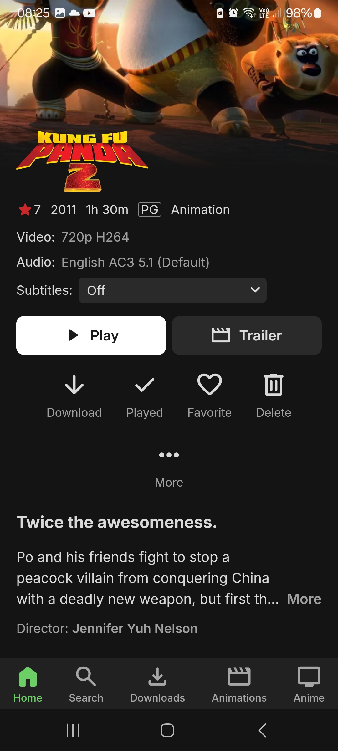

Techyon 0 Posted May 4, 2024 Author Posted May 4, 2024 Ok attached the server logs. embyserver(1).txt Here are some screen shots Firstone is the video playing Here is when i paused the video to show where it is in the playback And here i go to the home of the video and it did not record the playback history So it does not remember where you where in a video or if the video has been watched.
Techyon 0 Posted May 7, 2024 Author Posted May 7, 2024 So a interesting one. it looked like there was a issue with the client speaking back to the server. I enabled SSL for the server and only allowed the ssl port through but i saw in the logs the client was trying to connect on the non ssl port and was getting a 404 error, or a 304 I have now run a nginx reverse proxy in from of the emby server and this seems to have resolved the issue. not getting any 304 or 404 errors anymore. This is strange since i have done this many times and only this time did if give me this error.
