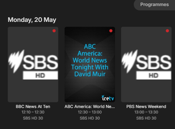

Noel-M 11 Posted May 4, 2024 Author Posted May 4, 2024 I recorded 3 consecutive programs on the same channel. Recordings start 5 minutes before and end 15 minutes after. * BBC News At Ten (30 minutes duration) * ABC America World News Tonight With David Muir (30 minutes duration) * PBS Newshour (60 minutes duration) All 3 recordings start with "BBC News at Ten". To view "PGS Newshour" I have to skip through both the other programs. Recorder TV directory listing attached. Check the size of the files on the emby server. * BBC News At Ten (50 minutes duration = 30 + 20) * ABC America World News Tonight With David Muir (80 minutes duration = 30 + 30 + 20) * PBS Newshour (140 minutes duration = 60 + 30 + 30 + 20) I note the creation time of the files is 5 minutes before the program start (as expected) Logs attached.. hardware_detection-63850431611.txt embyserver (2).txt

Noel-M 11 Posted May 20, 2024 Author Posted May 20, 2024 Hi Luke, Installed Emby Server 4.9.0.20 beta. This problem still exists. I recorded 3 consecutice programs - same channel - 30 minutes each (+ 5 mins before and 15 mins after) After recordings complete ... The span between [date created] and [date modified] is as expected. However, the [size] and [length] values indicates the problem. The 1st recording contains the first program. The 2nd recording contains the first and second programs. The 3rd recording contains all programs. Logs attached. hardware_detection-63851810294.txt embyserver (5).txt
