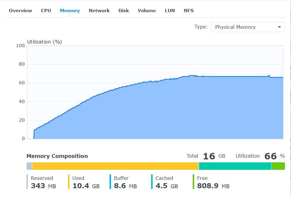

Statick 15 Posted May 29, 2024 Author Posted May 29, 2024 (edited) hey guys. I have increased the RAM in my synology to 16GB (it's supposed to be maximum 6GB but with the right RAM modules it will go higher) and updated to 4.9.0.22 beta I can now complete library scans, during the scan Emby RAM usage will increase to over 9GB before it completes, so it's no wonder I was unable to complete scans with only 6GB installed I have taken a screenshot of the RAM usage over time so you can see how it increases. it increases fairly steadily until the scan reaches around 60% at which point it still increases but more slowly (in the screenshot you can see the RAM usage goes down a bit before going back up again, roughly half way along the graph, this is at around 60-65% library scan). it then continues to increase at a slower rate until the scan hits 90%, then the usage remains constant until the scan completes. after the scan is completed, the RAM is returned to the system Edited May 29, 2024 by Statick
DonMacaroni 55 Posted May 29, 2024 Posted May 29, 2024 "Task Manager" screenshot would be better as current screenshot does not tell anything, what (process) actually consumes memory and how much. From developer perspective, it is useless... 1
Statick 15 Posted June 6, 2024 Author Posted June 6, 2024 (edited) that's the Emby process consuming almost all of that, as I've explained in my earlier posts. the reason for this screenshot was to show how the increase in memoy usage changes at different points in the library scan i.e it slows down when the scan reaches around 60% then levels off when the scan reaches 90% and does not increase anymore as the scan continues past 90%. I hoped this information may help track down exactly where the problem lies, as different stages of the library scan consume memory differently - obviously there's no problem with the part of the scan that happens beyond 90%, so developers trying to solve this can focus their investigations on the earlier stages of the library scan. showing this information seems like a helpful thing for tracking down this issue I already noted down from the task manager how much RAM the Emby process consumed, every minute for 20 minutes, and posted the figures in a table along with what % of library scan the server had reached, so sharing a screenshot of a single moment of that same information isn't going to tell anyone anything I haven't already posted, because that is literally the same information I already posted Edited June 6, 2024 by Statick

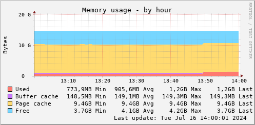

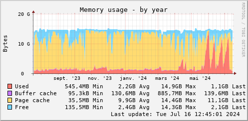

eldoctor 0 Posted July 16, 2024 Posted July 16, 2024 (edited) So, I'm running Emby Server on a debian machine (bookworm) and starting around end of may this year (upgrading from 4.7.11.0 to 4.8.7.0 on may 17th, upgrading to 4.8.8.0 on may 31), I experienced memory leaks of the EmbyServer processes, filling up the 16GB. I've obviously enabled logging with debug, disabled a few plugins and after a few weeks of diagnosing I came accross the fact that it is the scheduled « Scan media library » that is triggering the behavior. Set it to run every two hours, after a full night the process consumed ~22% of my 16GB. While the scale make it a bit hard to see, you can observe plateaus on the chart from tonight: those are moments I disabled the scheduled media library scan. As soon as I reenabled it, it is obvious there's some slow leaking. To the best of my experiments, disabling the scheduled task and manually running I can see e.g., the memory consumption of the process following the cinematic below: startup ~1.8% RAM consumed start media scan on one of the library, peaks ~2.1% scan completed within ~20s, finished and memory goes back to ~2.0% scan again, other library, peaks ~2.2% scan completed within ~25s, finished and memory goes back to ~2.1% Attached is a view of the leak from its beginning, as well as the experiment from tonight. There's nothing actionable in the debug log, all that is visible is that it is performing media scan successfully, listing the content like that: Quote 2024-07-16 10:41:54.185 Info TaskManager: Executing Scan media library 2024-07-16 10:41:54.225 Debug SqliteItemRepository: GetitemById AggregateFolder 15488 root 2024-07-16 10:41:54.492 Debug SqliteItemRepository: GetitemById Series 16683 [...] 2024-07-16 10:42:06.672 Debug ProviderManager: WaitForRefreshQueue waiting for 0 items in refresh queue 2024-07-16 10:42:06.687 Debug App: Running post-scan task CleanDatabaseScheduledTask 2024-07-16 10:42:06.751 Debug App: Running post-scan task CollectionLibraryPostScanTask 2024-07-16 10:42:06.753 Info TaskManager: Scan media library Completed after 0 minute(s) and 12 seconds 2024-07-16 10:42:06.755 Debug ProviderManager: WaitForRefreshQueue complete 2024-07-16 10:42:22.175 Info TaskManager: Executing Scan media library 2024-07-16 10:42:34.110 Debug ProviderManager: WaitForRefreshQueue waiting for 0 items in refresh queue 2024-07-16 10:42:34.110 Debug App: Running post-scan task CleanDatabaseScheduledTask 2024-07-16 10:42:34.143 Debug App: Running post-scan task CollectionLibraryPostScanTask 2024-07-16 10:42:34.143 Info TaskManager: Scan media library Completed after 0 minute(s) and 11 seconds 2024-07-16 10:42:34.151 Debug ProviderManager: WaitForRefreshQueue complete Since you mention database, the settings I have are a cache of 256MB, 4000 rows for analysis and trying to optimize on server shutdown Based on the charts and the upgrade log, I suspect it might be after 4.8.7.0 -> 4.8.8.0 upgrade that it started happening. Edited July 16, 2024 by eldoctor

eldoctor 0 Posted July 16, 2024 Posted July 16, 2024 My default value was ~8h I believe, changing to 2h for debugging purposes, even now sedt to every 15 mins, restarted the process when I posted the previous message and we're already at ~7.5% consumed. I have also at the same time reduced the cache size to 64MB and lines to 400, after checking recommended settings. My database file is ~33MB

eldoctor 0 Posted July 17, 2024 Posted July 17, 2024 (edited) 24 minutes ago, sa2000 said: The EmbyServer log would show what sore of action was being performed and if any new media files were picked and what type of media and this together with the detailed memory usage record should help narrow the problem area, As I pasted above, there's 0 action taken, and no new media. Scan completes successfully within <12 seconds on both libraries. And yet it leaks. The log above is complete, I just removed the noisy HTTP requests and the actual filesystem directories that were listed. The content i removed is: Quote 2024-07-16 13:04:19.277 Debug SqliteItemRepository: GetitemById AggregateFolder 15488 root 2024-07-16 13:04:19.530 Debug SqliteItemRepository: GetitemById Series 16683 /media/b65826a5-641a-44cc-b656-a5c11154c434/Vidéos/Séries/XXX [...] There's nothing new discovered. Regarding logs, the anonymized version still leaks quite a lot of personal data. What I could try is: Restart with schedule set to 15 min monitor with e.g. `$ cat /proc/3196917/statm | ts` This could produce a second-based output like: Quote $ cat /proc/3196917/statm | ts juil. 17 11:40:03 1180823 84607 21330 22 0 110042 0 Edited July 17, 2024 by eldoctor

eldoctor 0 Posted July 17, 2024 Posted July 17, 2024 (edited) Shared you the server log in DM, I have to wait a bit before sharing the statm log. Consumption in htop went from ~1.8% at startup to ~15.5%, running every 15min for ~2h Edited July 17, 2024 by eldoctor
