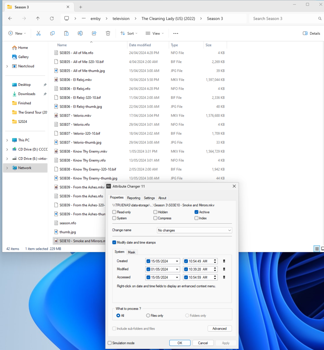

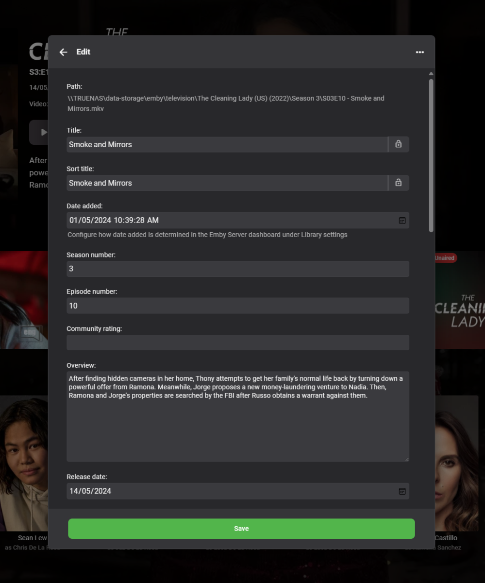

Trevor68 70 Posted April 29, 2024 Author Posted April 29, 2024 20 minutes ago, Luke said: No, Emby uses the Date Created timestamp, not Date Modified. Nope, in this instance (3 episodes), it has perfectly taken the date modified, and used it for date added. The 4.8 Emby server is writing the NFO's.

Trevor68 70 Posted May 15, 2024 Author Posted May 15, 2024 On 10/05/2024 at 13:28, Luke said: OK, we don't have any code looking at the modified timestamp of a file. The best way to troubleshoot is to try and reproduce with a new file. If you can't do that, that's OK, but we can only make guesses about what might have happened in the past. Maybe a defect in an older server version, problem in the dotnet runtime, problem caused by plugin, etc. And yep, absolutely repeatable, emby is using DATE MODIFIED as the DATE ADDED, every single time, despite what you say.
Luke 42290 Posted May 23, 2024 Posted May 23, 2024 Can you please provide the emby server log from when the episode was first imported? Thanks.
