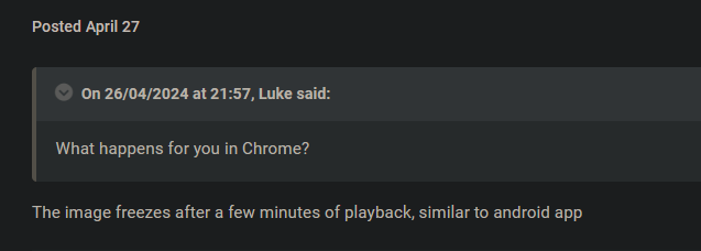

BlackDub 50 Posted April 27, 2024 Author Posted April 27, 2024 10 hours ago, Luke said: What happens for you in Chrome? The image freezes after a few minutes of playback, similar to android app
