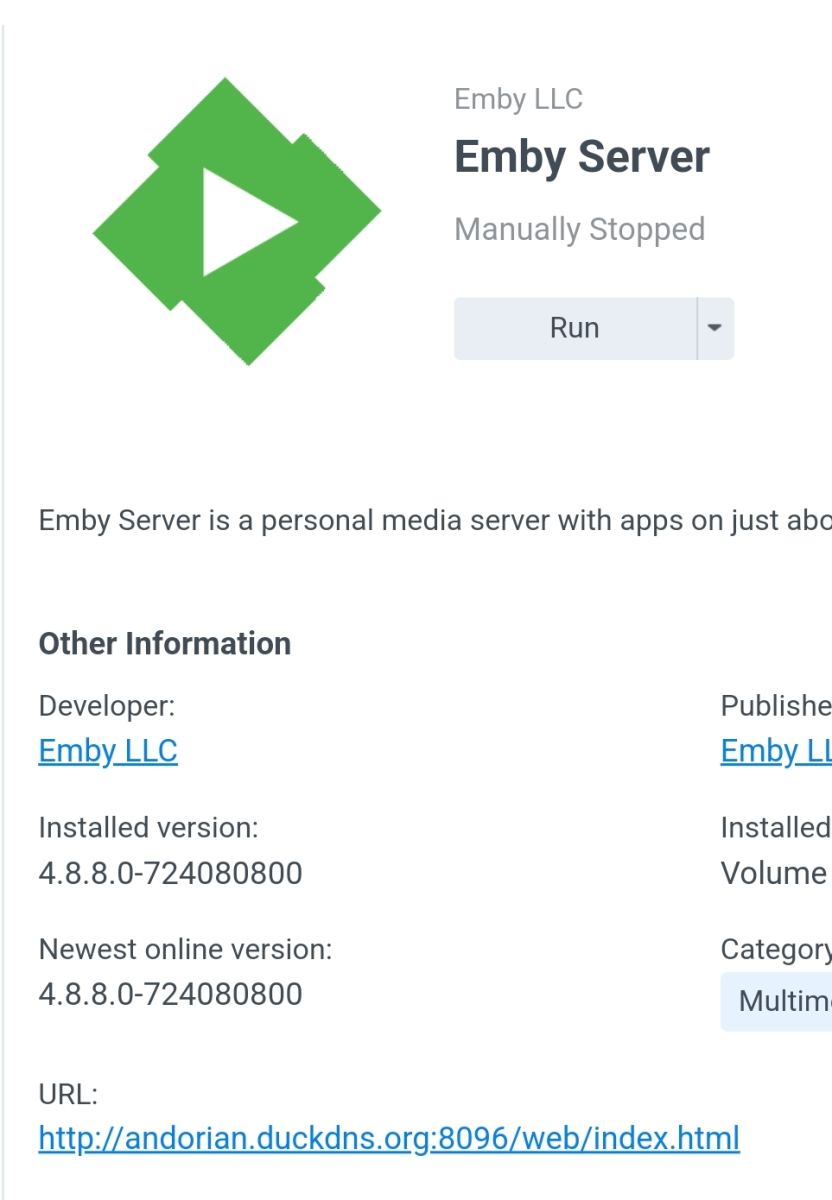

Luke 42241 Posted July 22, 2024 Posted July 22, 2024 OK, that's progress. Where does it say manually stopped?
Bobby121418 17 Posted July 22, 2024 Author Posted July 22, 2024 Just below Emby server in Package center. Please see image above. Thanks
