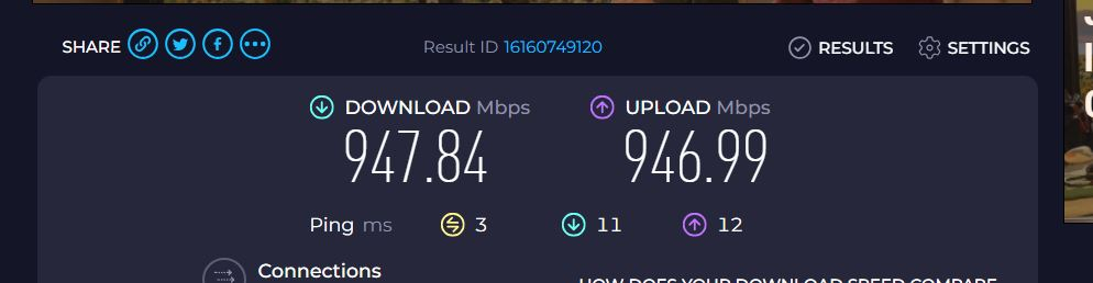

Jey2024 33 Posted April 22, 2024 Posted April 22, 2024 Hey guys, I've noticed my Emby streaming has been getting stuck in the past 2-3 days, and I'm not sure if there are any settings on the Emby side that I need to change. Firstly, I noticed this issue on my Android app - I move around a lot and had full bars of 4G coverage. The video would stream fine and then suddenly stop. I'd have to go back and start again. Just a while ago, the same thing happened in my web browser. I was quite surprised because I'm not using Wi-Fi, but rather a direct LAN 1GBPS internet connection. When I checked the stats, it showed some transcoding information. Can someone take a look at that and tell me if it's causing an issue? When I refresh the page, it shows a blank screen. Please see the attached screenshot (emby2). In my Android app, I purposely reduced the quality setting to 720p - 1Mbps. To be honest, mobile streaming is not an issue, but I wish to try and fix the web streaming if possible. I've already opened a ticket with my seedbox provider but wanted to know if there's anything I could change in Emby. Thanks J
Jey2024 33 Posted April 22, 2024 Author Posted April 22, 2024 I'm also attaching a screenshot of my internet speedtest. And all other streaming like youtube is working just fine. I'm running - Version 4.8.3.0
