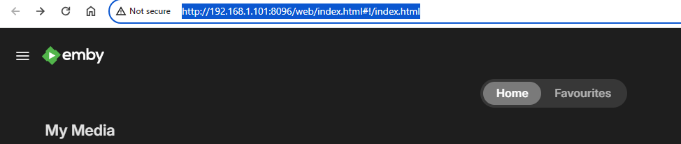

AJAYSWebDesign 5 Posted April 23, 2024 Author Posted April 23, 2024 7 minutes ago, Luke said: I would suggest leaving that blank unless you have a specific reason not to. I just removed the IP and whammo! I;m back in! The only reason I changed/set the IP was it previously was not displaying (see my initial screen shot). Now it displays: In-Home (LAN) access: http://192.168.1.101:8096
AJAYSWebDesign 5 Posted April 23, 2024 Author Posted April 23, 2024 bugger - Firewall just restarted... i can connect on my pc to below... but now i can't access via my ipad.... therefore issue must be AVG firewall

Solution AJAYSWebDesign 5 Posted April 23, 2024 Author Solution Posted April 23, 2024 3 minutes ago, Luke said: So now it's 101. Once you start setting it explicitly, then it becomes your responsibility to keep it up to date if and when the value might need to change. Hold on - the only reason i changed it, was because Emby wasn't displaying the IP address - as mentioned above (refer to initial screenshot). As it turns out, the issue appears to be with AVG Firewall, not the changes i made!! I think I've solved it - AVG introduced a 'default' rule that i have now deleted and have access via Ipad (see my third post compared to settings below). 1
