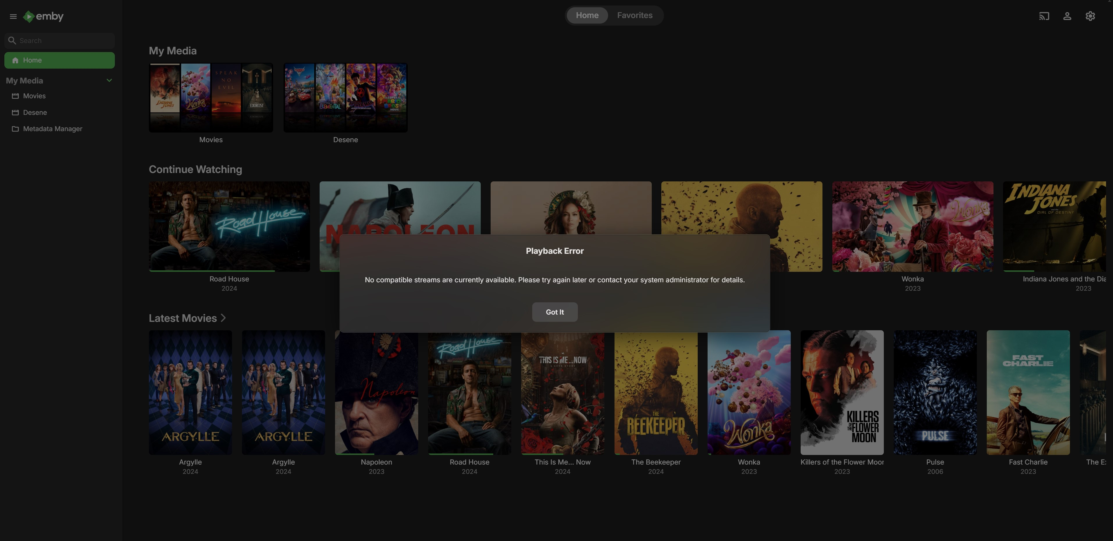

infinitynet 0 Posted April 21, 2024 Author Posted April 21, 2024 (edited) I gave as much time as it needed. Here is the print screen with the error, and I dont think it is from the movie... Should i keep that error window more time? Edited April 21, 2024 by infinitynet
GrimReaper 4843 Posted April 21, 2024 Posted April 21, 2024 From that last log can't say why it's failing, it ain't throwing any errors. Maybe it's a bad encode, maybe ffmpeg doesn't like something about it, as it should be a breeze for your RTX 3050. @softworkz
