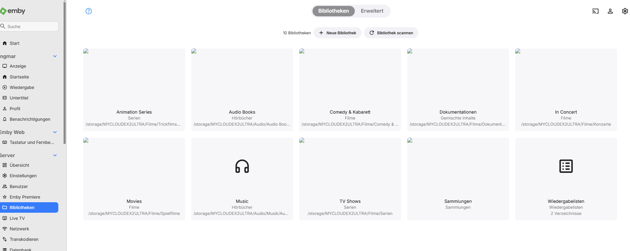

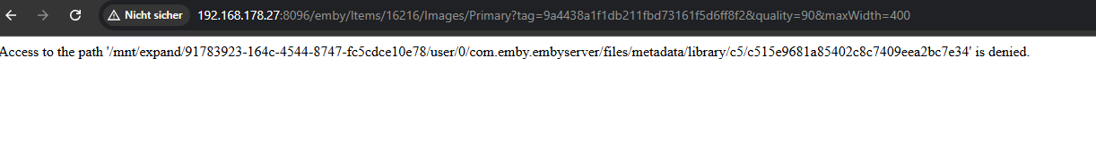

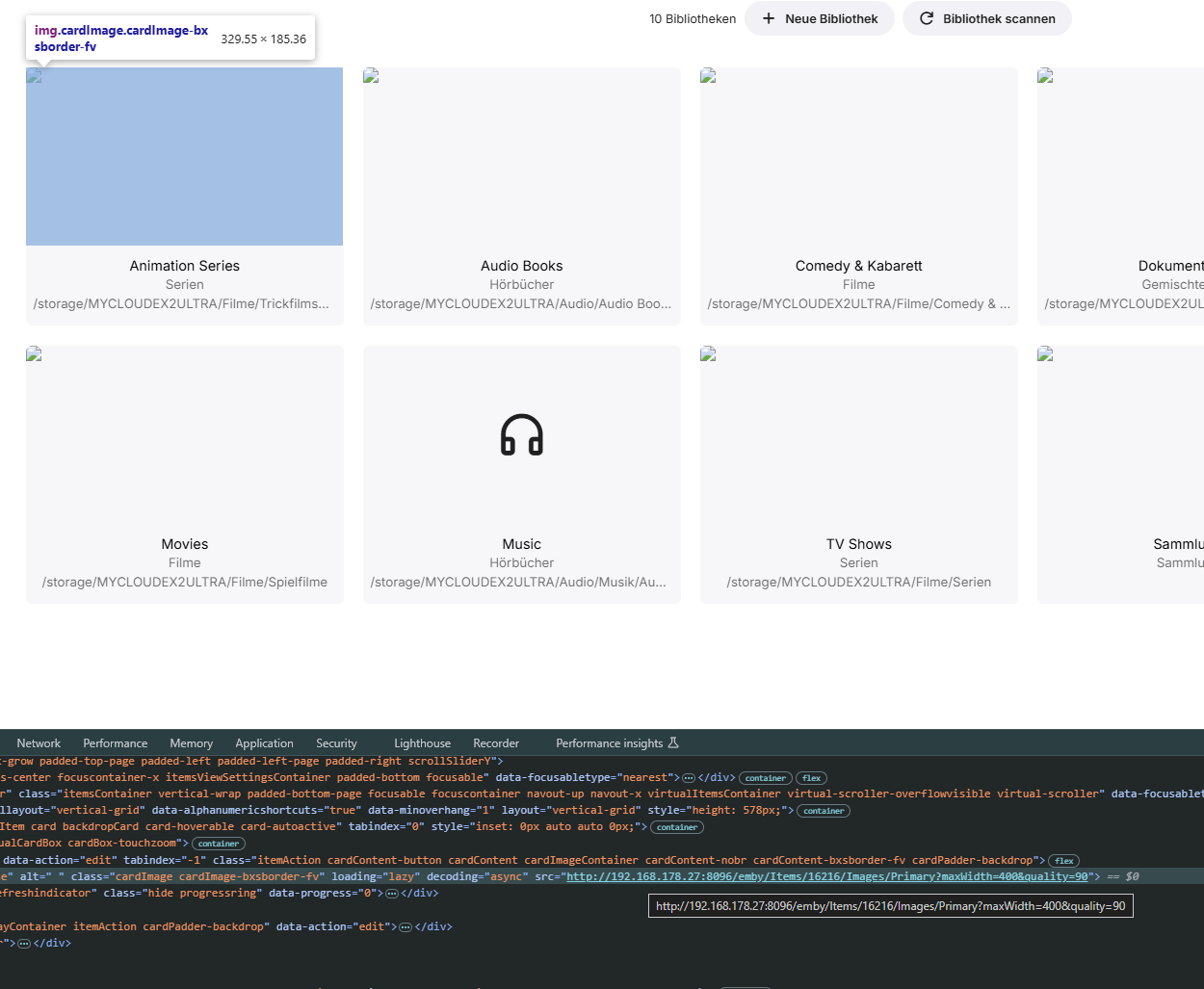

ingmar_ehrig 1 Posted December 11, 2024 Posted December 11, 2024 It's me again Seems there is a preoblem with access rights management. Opening emby server in the browser shows broken image for my main folders (movies, TV shows, music, audiobooks etc.). Looking for the broken path manually the page says "Access to the path '/mnt/expand/91783923-164c-4544-8747-fc5cdce10e78/user/0/com.emby.embyserver/files/metadata/library/c5/c515e9681a85402c8c7409eea2bc7e34' is denied." I suppose this to be a problem resulting in moving the emby server app back and forth from the extended internal memory to the original internal memory of the shield. So I think I have to grant access to whole thing for the emby ser app again manually. How can I set the path to be accessable through emby server? I only have a windows system (and the shield), so I think I can't do any sudo CHMOD777 operations or something like that. To make it clear: The SSD connected to my shield via USB is formatted and connected as an internal memory device, not an external data memory device. Any ideas?
