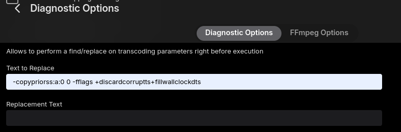

Luke 42241 Posted May 10, 2024 Posted May 10, 2024 OK can you install 4.8 and then the diagnostics plugin. The plugin has a method to alter our ffmpeg command line via search and replace. Let's try a few things and we should be able to get to the bottom of this. Please do a search and replace on this: -copypriorss:a:0 0 -fflags +discardcorruptts+fillwallclockdts And just replace it with empty. If that doesn't help, then try each of these individually, each time replacing them with empty: -reconnect_on_network_error 1 then -reconnect_on_http_error 5xx,4xx Please note all three of these search strings have a blank space at the beginning and no space at the end. Let's see if one of these three resolves it. Thanks.
