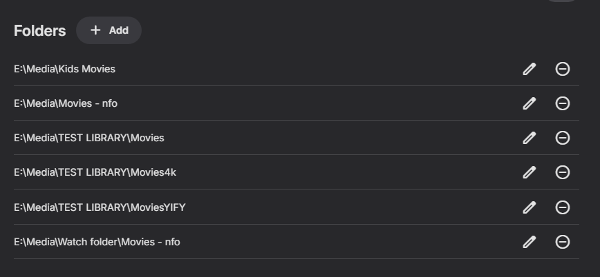

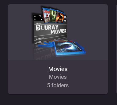

kikinjo 294 Posted May 15, 2024 Posted May 15, 2024 (edited) Same here happened to me, added another folder in library, 4 folders were already in library. Btw if u add 5th folder u cant see it in emby admin gui at all After adding folder, whole server lost content completely...after 2 hours of trying to fix it..unsuccessfully, i restored backup... Same error messages as already posted, Sqlite mostly. About number of folders....here is screenshot, i have 5 folders in this library..only 4 are visible in UI , on adding 5th i got sqllite crash.... Edited May 15, 2024 by kikinjo
js28194 42 Posted May 15, 2024 Posted May 15, 2024 I have no issues adding 5 folders. Don't have this problem on Emby Server 4.7.13.0

Happy2Play 9814 Posted June 7, 2024 Posted June 7, 2024 On 5/15/2024 at 10:33 AM, kikinjo said: Same here happened to me, added another folder in library, 4 folders were already in library. Btw if u add 5th folder u cant see it in emby admin gui at all After adding folder, whole server lost content completely...after 2 hours of trying to fix it..unsuccessfully, i restored backup... Can't reproduce a number of folders issue in my testing in stable or beta
