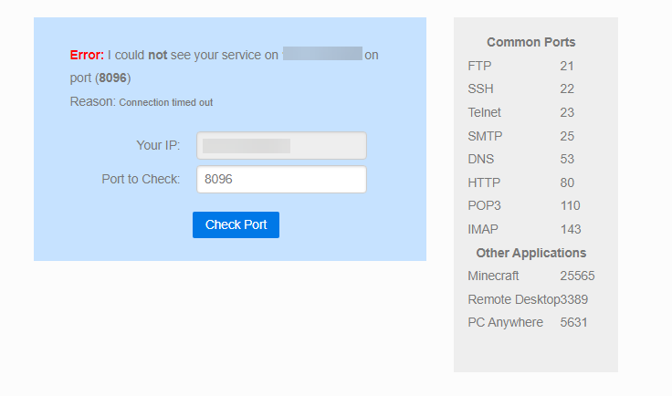

Lessaj 479 Posted April 10, 2024 Posted April 10, 2024 Did you confirm the port is open from canyouseeme.org? Please provide screenshots of your port forwarding settings in your modem/router.
storyhobbit 0 Posted April 10, 2024 Author Posted April 10, 2024 Doesn't look like it's able to see it. No port that I entered made a difference. And I'm not really certain what you mean by the "port forwarding settings in your modem/router". How do I see those?
