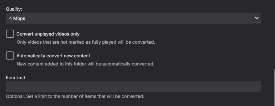

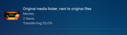

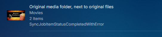

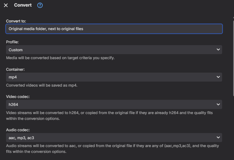

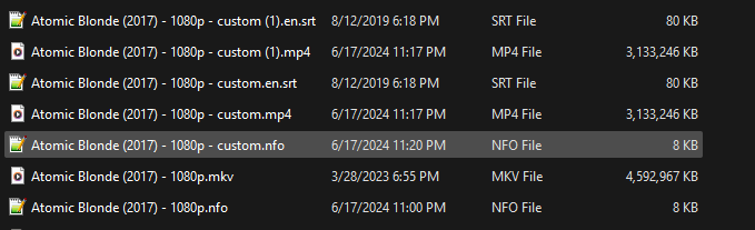

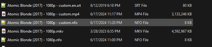

Happy2Play 9814 Posted June 18, 2024 Posted June 18, 2024 9 hours ago, Luke said: When you setup a conversion job on a folder, it will convert everything that doesn't already match the target format that you're converting to. Okay I setup a folder to convert to Error is understandable as on file was a dummy. All good but if this job is deleted and readded as OP did. Conversion happens again. On 4/9/2024 at 6:12 AM, darkassassin07 said: Allow the job to complete; clear it from history; add it again and it reconverts the same 400 files again. So I believe the same question applies as to how History is maintained and it appears if you clear any job and recreate job everything will be redone even if a custom with same conditions already exists. .
