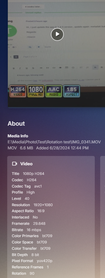

teicang 34 Posted May 3, 2024 Author Posted May 3, 2024 10 hours ago, Luke said: Hi, with Emby Server 4.8.5, what you'll need to do is refresh the metadata on existing titles. This will add rotation information to your server database. HI @Luke , I have done it, as you can see from media info appear now the rotation field, unfortunately different from the picsture posted by sa200 I have -90 and not 90
sa2000 695 Posted May 3, 2024 Posted May 3, 2024 (edited) 20 hours ago, Luke said: With Emby Server 4.8.5, what you'll need to do is refresh the metadata on existing titles. This will add rotation information to your server database @LukeHaving the rotate info does not help with this issue of portrait videos being rotated I have reproduced the problem again and I have media file and logs available. I have this time also tested on the Emby Samsung App as well and Emby Web and also Android App and repeated the ios app test and also added Emby Theater Outcome of my tests: Emby Server 4.8.5.0 on Windows 11 Emby Web - the issue only arises when forcing transcoding by reducing quality, Direct Play is ok Emby for Samsung 1.7.0 - the issue arises with auto quality and direct play and auto aspect ratio. It also happens with reducing quality to force transcode Emby for iOS 2.2.17 - same outcome as Emby Web. OK on Direct Play. Wrong when Aspect Ratio Auto and quality reduced forcing a transcode Emby for Android 3.3.86 - same outcome as Emby Web and Emby for iOS - OK on Direct Play. Wrong when Aspect Ratio Auto and quality reduced to force transcode Emby Theater 3.0.20 - same as web, ios and android. DP ok, Transcoded playback wrong Edited May 3, 2024 by sa2000 1

Happy2Play 9811 Posted May 8, 2024 Posted May 8, 2024 (edited) On 5/3/2024 at 12:39 AM, teicang said: unfortunately different from the picsture posted by sa200 I have -90 and not 90 This is really irrelevant as it just means you held the camera the opposite direction. But for the test I would expect the Samsung version 1.7.0 (12/27/2023 9 versions behind) to be an issue as it is old and would guess does not have current changes. But for all the reset yes direct play works and transcoding does not work correctly. Edited May 8, 2024 by Happy2Play

teicang 34 Posted June 28, 2024 Author Posted June 28, 2024 Hi , I just update the app to 1.8.5 version , update again metadati but the problem is yet present all the movies has -90 indicazion. They are player rotat3 ;-( so I cannot use it Regards /Gianni
Happy2Play 9811 Posted June 28, 2024 Posted June 28, 2024 8 hours ago, teicang said: all the movies has -90 indicazion. They are player rotat3 ;-( so I cannot use it Don't follow as -90 is really irrelevant as it is just the way you held the camera as the end result is the same correct presentation Many need a better example of your issue.
Happy2Play 9811 Posted June 28, 2024 Posted June 28, 2024 (edited) Same for no rotation or -180, they are present in the correct orientation. So are you saying the Samsung app is not presenting the correct Orientation ie sideways or upside down still? As your image appears correct. Edited June 28, 2024 by Happy2Play
